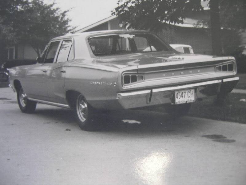

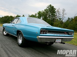

Hello Can someone confirm if the taillights on a 68 Coronet and a 68 Coronet RT are the same other then the black paint. Also, what is the Black, Flat , Semi Gloss ??
Thanks
The lenses may be the same but the housings are different along with the tail panel.

R/T & 500

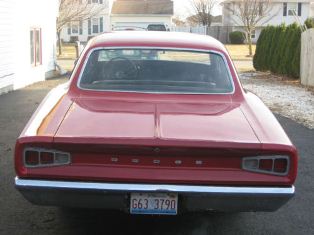

the same housing with the rear panel with either R/T or 500 emblem)
I can't say for sure about glosss black,but I can say I have not seen any painted flat.
Now you got me wondering.
Coronet, Coronet 440 & Super Bee are the same housing with no rear panel.
