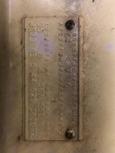

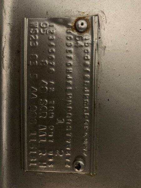

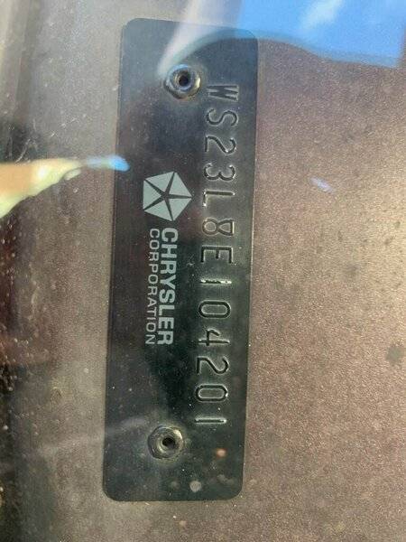

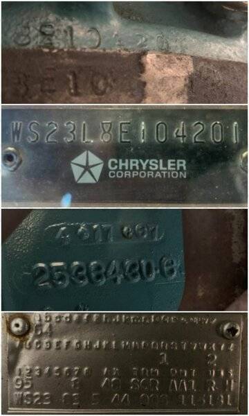

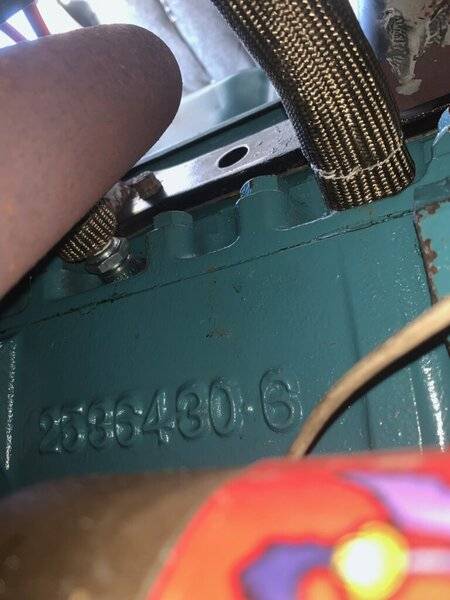

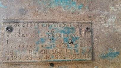

I'm looking at a 68 coronet and owner claims matching no. Motor so I'm trying to verify but it's blowing my mind some. Owner has sent photos of vin and fender tag and a few no.s from the engine.

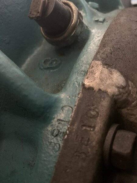

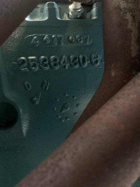

1 on bell housing and engine where it attaches to bell housing 8E10421 then a couple raised no.s. one gives the date 4 17 67 with possibly serial underneath and a D N with arrow pointing at the N
And another raised no. Looks serial to.
The no.s on bell housing engine 10421 match the vin tag
Can anyone out there help please?
Thanks heaps john

Welcome from NM. Looks like you have an RT there. Lots of knowledge on this forum. Somebody will know about the numbers.

The numbers on the side of the block is the casting info and part number
Cast on 4-17-67 D=day shift and N=night shift
2538430-6 is the casting number for the block the -6 is the mold revision/repair number.
The partial vin on the bell housing flange looks to match the dash vin so probably the engine it was born with.
On a different note it Looks as if the bell housing has been repaired?
Is it a mis-stamp or a not very hard stamp?
I see a "104..." something on the block near the bell.
It's awful close and the casting date looks about right for the car year.

On 1968 mopars, the sequence number is stamped on the block and bellhousing just like in your pics. My 68 Road Runner is the same deal. Congrats on the numbers matching engine and tranny!

To me this is obviously good data showing the LA plant stamped the VIN as early as September of 67. The casting date fits with SPD of the car. It would be interesting to see the engine assembly date stamped on the front pad to see how long it was between casting and assembly.

There is a weld on the bell housing the current owner said before his time (he's owned 8 years) so not sure what that's about. I've asked him to find the no. On the flat pad that you guys are calling the assembly date? But he can't even find the flat pad and I don't know where that is either. Also what's the spd? I've bought the official records online for the car and they state an engine and chassis no. That he hasn't seen yet but must be on the car somewhere?

The chassis no. WS23L8E104201

Ok I would assume your # is 8 28 (Aug 28) which sounds plausible for the build.
April cast on the block sounds a bit weird..
But anything possible..
