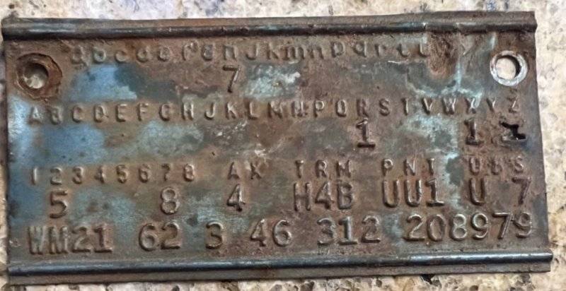

68 fender tag .
Big bill
7:24 AM
Jul 28, 2018
4,397
7,291
Clare Michigan
I was wondering if anyone could decode the tag for me ?
68 coronet 440 2dr post 383 4 bbl 4 speed 323?
I think that would require a number under the top w
super bee
not an ordered car. It would be top line little U with a 1 under it.
The interior is blue, H4B The B is blue, X is black.
the upper door frames are code U light blue.
AM radio
3.23 open
fender turn signals
tinted glass all windows
transverse sport stripe -white
super bee
AM radio
3.23 open
fender turn signals
Thanks it look like it has blue int .
Super Bee (WM)
2dr post (21; no other option than Post for a SuperBee in '68), 383 4 bbl (62), 4 speed (3), 3:23 (4 under AX "A")
bench seat interior. (H4B: 4), Built March 12, 1968
The interior is blue, H4B The B is blue, X is black. (H=Vinyl)
the upper door frames are code U light blue. (UBS: U-U)
AM radio (R-1)
open (nothing under AX "X")
fender turn signals (h-7)
tinted glass all windows (X-1)
transverse sport stripe -white (UBS: S-7)
Add to the above:
UU1 = Monotone Light Blue Metallic exterior
46 = F70-14 White Sidewall/White Streak tires
2-5 = Drip rail moldings
7-8 = Wheel opening moldings
This model was built at Lynch, LA and St.L; inspector's stamp looks like St. Louis to me, so WM21H8Gxxxxxx VIN?

Agree that X is black, B is blue. Brain fart on my part. I gotta quit feeding my brain beans! I don't think I have ever seen fender turn signals on a Super Bee. More of a Plymouth thing.
