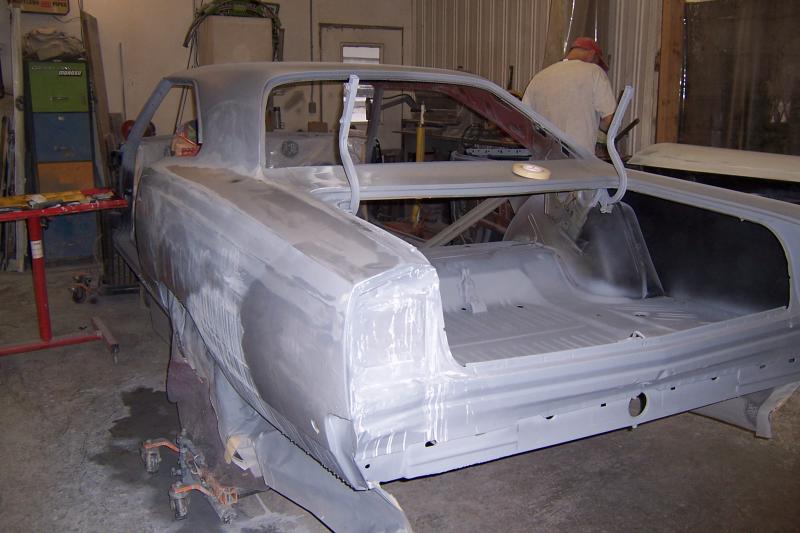

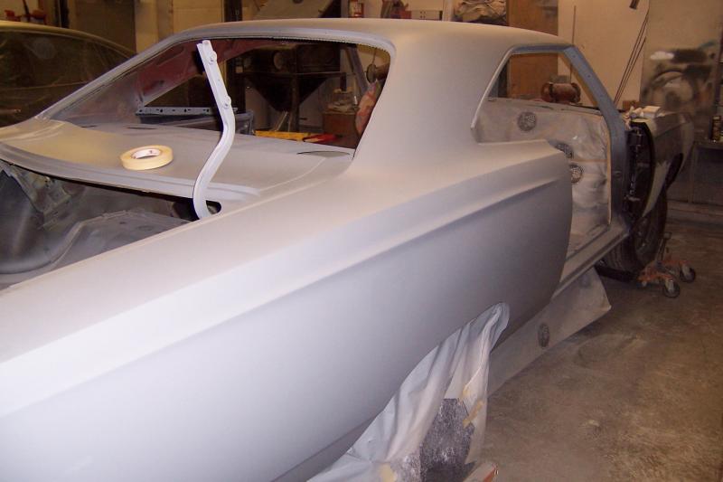

Dave. I have to agree with some of these guys. Media blast the whole car if you can. This way your not chasing panels every month. I posted some of my pics. I Media blasted it right down to bare metal on the whole car. Just my advice

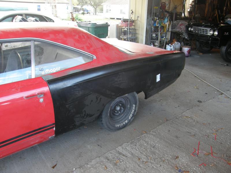

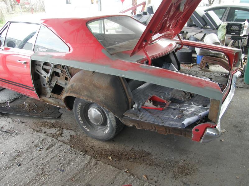

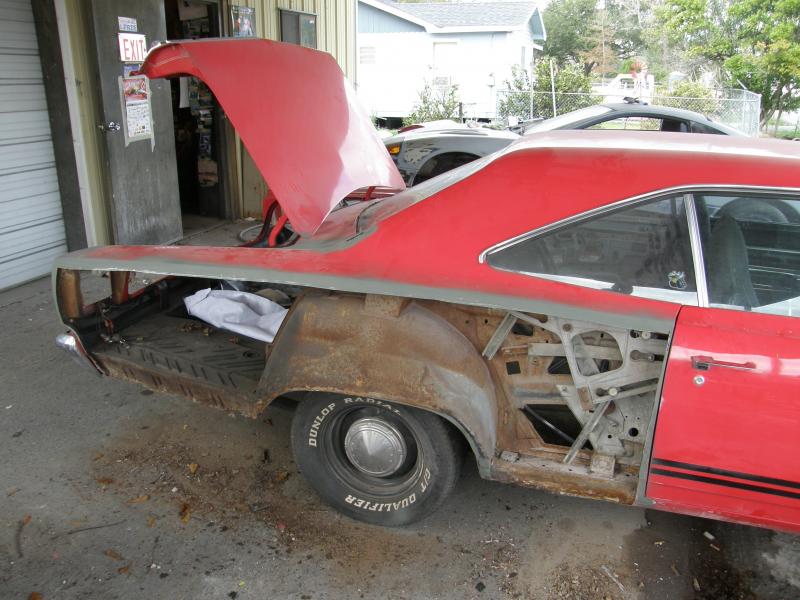

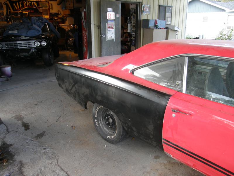

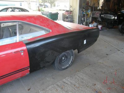

Here is a update, remove 1/4s, outer wheels houses are good, lower trunk ext bad. Fit 1/4s on, waiting for lower trunk ext. Going to clean up outer wheel houses. I am still working full time so this restore will be a mechanical strip and fixing of 40 years of abuse. After I retire I am going to pull it all apart and media blast it then.

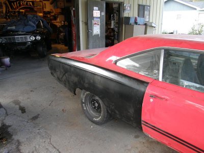

Driver's 1/4 cut and fit, hope to get pass done this weekend. Rear glass leaking and installed wrong. That will be the next project.
Dave F
Yeah, go man go! Car looks very solid underneath that quarter. Scrape off the loose and scaley rust and hit it with a rust converter or encapsulator and move on!
Nice job so far. I take it your kids are grown up if you have them. I couldn't move that fast.
