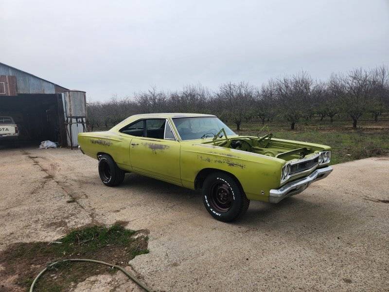

Putting some weight on the springs will flatten them out and make the front segment longer. Your car looks mostly gutted, I would avoid messing with the stance until it’s nearly complete. It will change a lot, especially with tired old springs…
You read that part with I ordered new springs? Dose this look "gutted" to you? Asking for a friend.

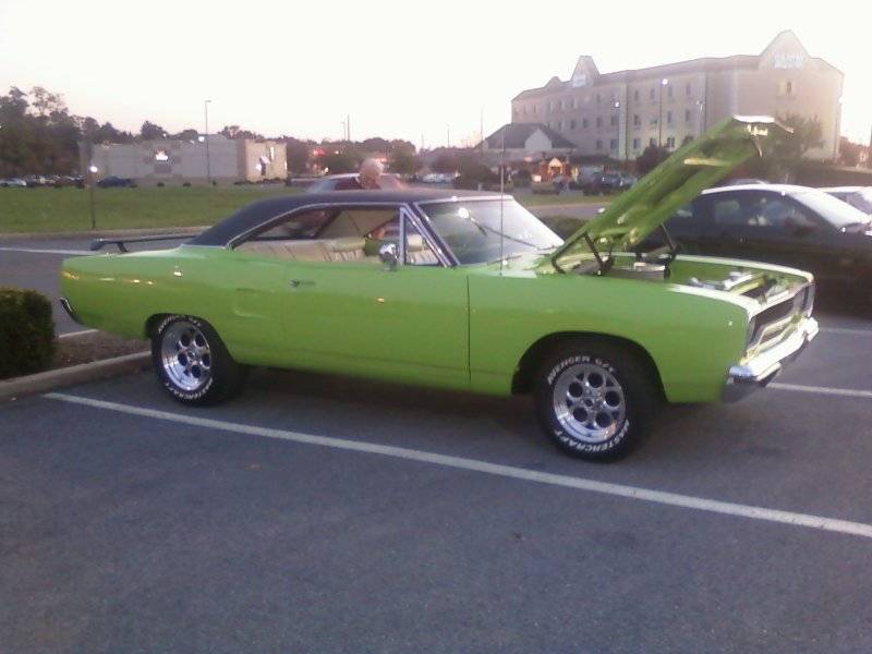

Same size 275 60r15 I just prefer this stance.
That is about where my car sat as it was going together after paint...
Only real difference is 275/60/15's are a good bit shorter than 275/60/17's...
I have SS springs on mine and it was just too high for me...
After the back glass went in I added 1" lowering blocks and it was about right...
3 years later I added about 200# of stereo equipment it went down some more...
Wheel offset in combination with actual tread width is the key to making one look like it is really stuffed with tires...
My rear wheels are 17" x 9.5" with 5.5" backspacing...
That is what worked well with a tire that has an 11.25" section width...
A narrower rear tire can use a wider wheel...
If a high stance is all you want as long as nothing rubs a lot of this doesn't matter...
