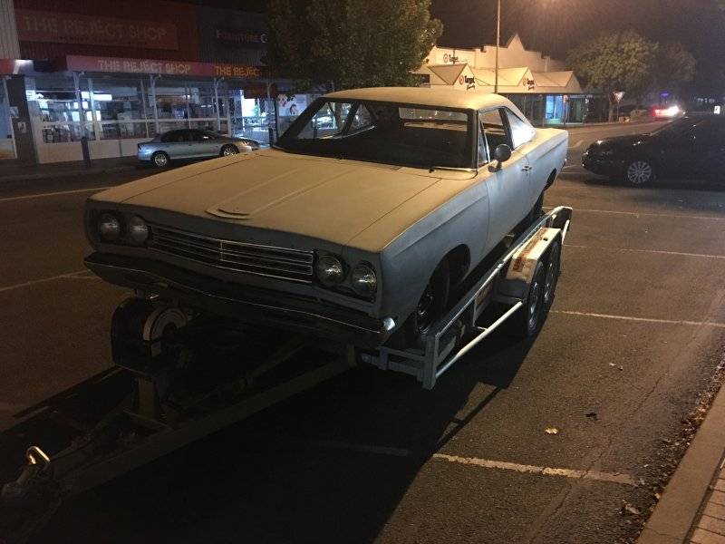

Merry Christmas everyone.Hi I am restoring 68 Roadrunner.Would anyone know if it should have rear trunk panel moulding?I have seen pictures of 68s some have them and some not. I have vin tag.Would I be able to tell from that?

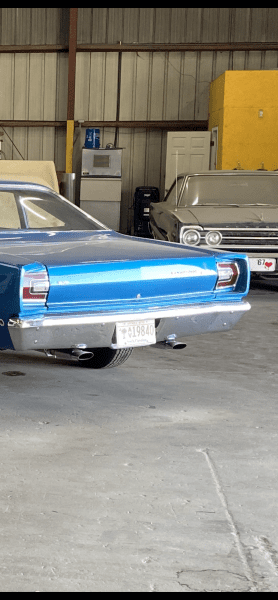

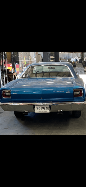

I think it was part of the décor package.
If I’m not mistaken, it was standard on all hardtops in ‘68. The “Satellite” version was added mid year.
No FT code for Decor Group, but if the Satellite-level interior is on the FT it would have to be a Decor car.
'68 HTs (RM23) were all Decor, for Coupes (RM21) it was optional starting when the HTs were introduced mid-model-year.

My 2 cents: Decor package added the finish panel on a 1968 Road Runner. Standard on Satellite, optional on Belvedere.
Sport Satellites and GTX got the "pot metal" chromed finish panel. Check out some factory brochures, data book, parts book, and service manual.

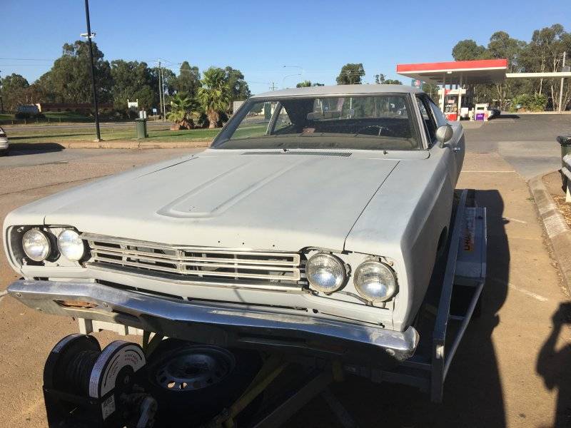

It has the Belvedere hood and 69 grill that I have had to change out
