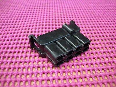

Hello Ranger 16. I am still working on getting my RR to start. I replaced my ignition switch and that might have helped (my old one had some resistance between the battery input and the start terminals at the switch). I now still only get 9.6 V at the coil in start (even thought it does crank the starter). Now I want to look at the brown start wire that goes to the resistor (bypass) to the coil at the bulkhead.
Here is a picture of my bulkhead connections. Is this like your 69? Do you just pry the three individual connectors (each with 8 wires going in) off at the nubs where it attaches to the main connector? And can just the middle one be pulled off to try to get at the spade connector to check for oxidation/corrosion or whatever?
Each one of those three connectors can be individually removed. Look closely and you'll see a locking tab on each side that needs to be released to pull the connector.
The locking tabs show up pretty good in this picture. A long thin bladed screwdriver works well in the little slot you see at the base of the tab to gently pry it back just enough to release the tab and pull the connector.
Sounds like you are not bypassing the ballast resistor. You should be getting a full 12v while cranking and then drop back to 9.6 (or so) when running. Are you sure the ballast resistor is wired properly (not bass ackwards)?
