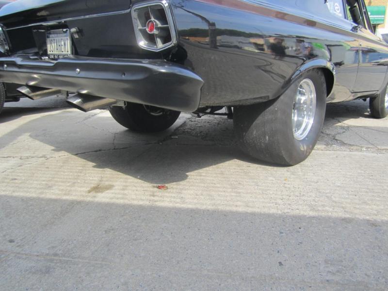

Thank you both for the advice im going to check into chris's chassis and s&w. Back halfing was what i was originally thinking and it would be used for both street and track use. I would like to be in the 9s with this car. Im new to drag racing so im not really sure what class i would be looking at
Unless your a good welder/fabricator,,,,,,,,,,take it to a chassis shop that did a lot of FAST cars. You don't necessarily need to back half.
I think this car will need a back half or full chassis as the rear frame rails are almost non existent due to sitting in the weeds for 21 years. I do have alot of experience with a welder my initial plan was to knock out all the body work then install a back half with 2x3 connecting it to the front. I will have to see if there is a good chassis shop around me (central ny) rochester area
