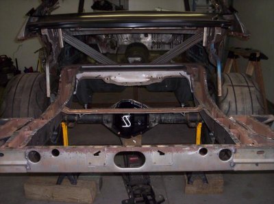

When I bought my Satellite, I knew that she was no prime specimen. The rearward rust issues would be there. Now, looking back at things, I believe I've been quite lucky, all things considered...
Sail panels were ok, all the important stuff underneath the car was solid. The sheet metal, however, was not; rear quarters were brown and bubbly, and I could even poke a hole in the driver's side panel with my finger... also, the trunk floor was a mess, Swiss-cheese-wise. Rust had eaten its way through, making new interesting passageways for exhaust fumes into the car...
So, a few e-mails and phone calls to Mr. Larsson of Larsson Customizing, a most Mopar-competent welder, and Satty was driven to surgery...
Heres's what she looked like when I got her:

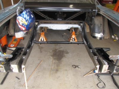

... and today, with some nice and crisp steel:
This side seemed ok at first, but on a closer look, it was nearly as rotten as the driver's side. Mr. Larsson made the replacement parts from scratch instead of ordering from overseas and waiting for weeks:
The deck filler panel was also cut out and replaced, trim holes were welded shut and left fender was fixed - apparently, it was bent and cracked, probably due to a collision.
Getting the car back next week. Then, it's time for some serious epoxying...
Nice work ! Been there,done that myself (two times ) Keep on !
looking good keep us posted on your progress
Yeah, I'd say you were pretty lucky. You could have been blessed with doing this:
Looks like your body man did a pretty good job! Happy Moparing!
Like Propwash said! Your making good progress!!!!
Thanks guys. Yeah, I lucked out on the rust - load bearing parts are healthy. And yes, mad props to Larsson Customizing - my sad spot welding skills would not have been enough to fix this...
Another pic - after removing the deck filler panel, the surrounding sheet metal was promptly removed... turned out it wasn't metal any more... so, Another piece was made:
I'm actually not sure if this is the piece next to the package tray area or the package tray base itself - but it looks nice. Also, I got rid of the Sport Sat chrome trim - body man had lots of holes to fill...
So, I'm off to pick up the car tomorrow. Next task is to get her home and get some epoxy primer on that bare steel...
