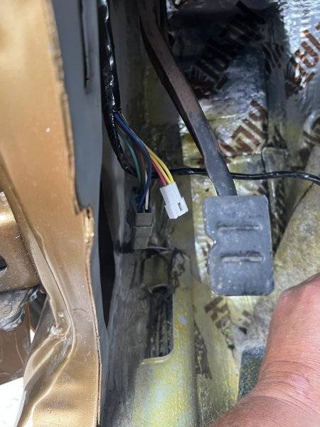

Hi all,

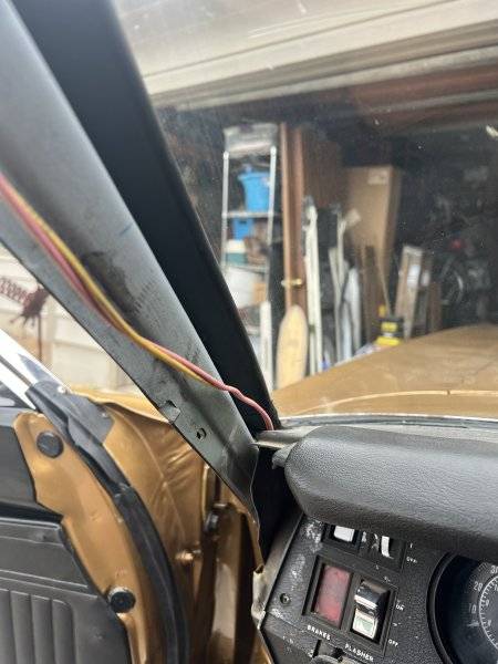

Dome light:
In the effort to continue learning this car and reconnecting the things that were not connected, the dome light harness that runs from the light down the driver side A pillar has a different connector than the one that came in the new harness for the Rallye dash. The light harness connector is T-shaped and female with spade connectors while the connector on the dash harness is female, has 2 pins with the 2 yellow wires and single pink. From looking at the wiring diagram, it looks like there may be some kind of intermediate harness? That goes between the dome light harness and main dash harness? If so, any idea what it's called and where to get it?

Wiring may be hacked. The trunk lite option has a pigtail option. Trunk lite plugs into the dash harness, dome plugs into the trunk harness. The connector is kinda square with a pointed nose.
Least, that is how my '69 Road Runner is.
Not sure about the 4-way.
Thanks Bird,
The wiring from the trunk looks to be original and the dash harness is new. I do have the pointed nose plug you mention. But the wiring that goes to the trunk connects to a rectangular connector from the main dash harness. And the harness from the dome light goes down the A-pillar behind the dash to a T shaped connector with 2 spades. Is there a connector somewhere that I'm missing? It seems I don't have the connecting end to that pointed connector coming from the main harness.
I just looked in the trunk, and felt all around. I have no trunk light switch, nor do I seem to have any wiring going up to the trunk lid.
Thanks Bird,
Trunk light was an option and a separate wire was run for it as I recall.

Any other harnesses with yellow and pink wires are the map light, key light, console lights. Rally and standard still have all the same dome and accessory wiring.
Thanks. So I guess I don't have the light package as I don't have a trunk light or a map light. In that case, can I simply connect the dome light harness to the one down near the kick panel if I replace the connectors?
