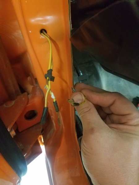

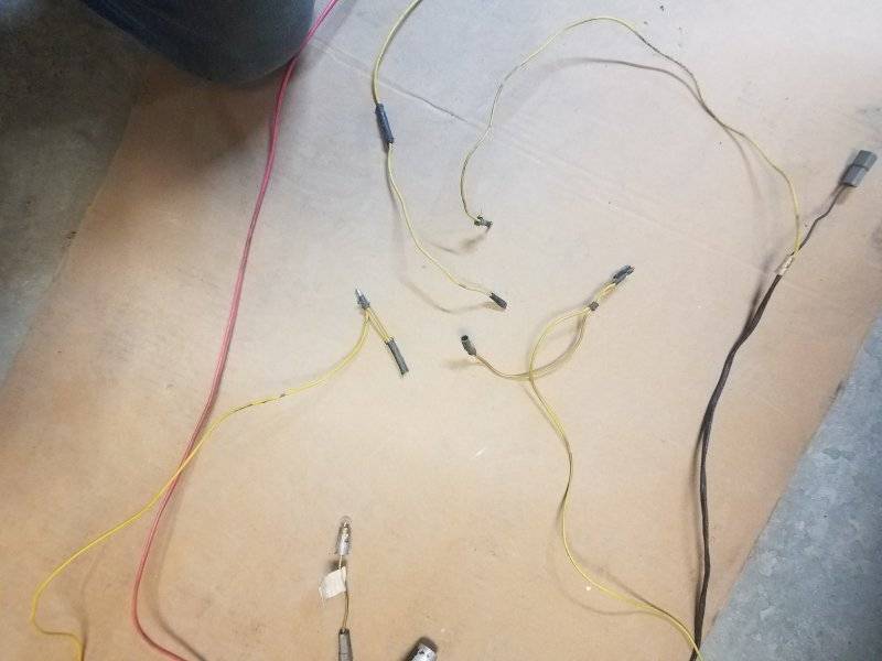

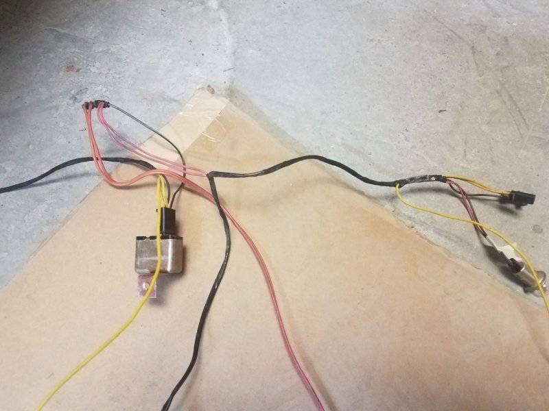

I'm in need of help figuring out what gets connected to what with an accessory harness. It appears to be part of the door jamb switches and includes the console, a box with 3 terminals (buzzer?). The Shop manual only has a diagram for the Dart and doesn't include the harness(es) I have. Thanks!

View attachment 1462720View attachment 1462721View attachment 1462722View attachment 1462724
Is the dash out of the car? The buzzer is a headlight on that activates with the lights on and the door open.

I don't see the round time delay. Do you have the A01 Light package? If so, you'll have a connector to the dash harness. you will have 2 yellow wired to the door pins, unless they were changed to single connectors(non light package), map light, ash tray light, and ignition light(with delay)
The color harness helps

In the FSM you will not find the wiring under Charger. Go under Coronet it is the same harness for the buzzer, map, key light. Pages 8-104, 8-105, 8-106, 8-107. Follow the circuits out and you will get it. Post any questions and I can most likely answer them.

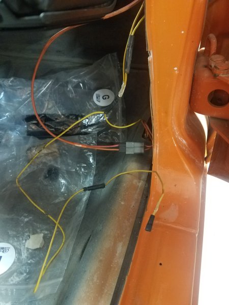

I think I have it mostly sorted out. Small issue, I have 3 yellow wires at the left door switch and one on the right. None of the ones on the left are physically long enough to reach to the right side (original wires).

Do not let it fool you. Look at my photo 3 yellows to the right.

Here is where I am so far (the blue wires on the lower harness are the rear speaker wires).
Also, not sure if you saw my next question on the ignition light? I don't have a bracket/holder for the bulb.
