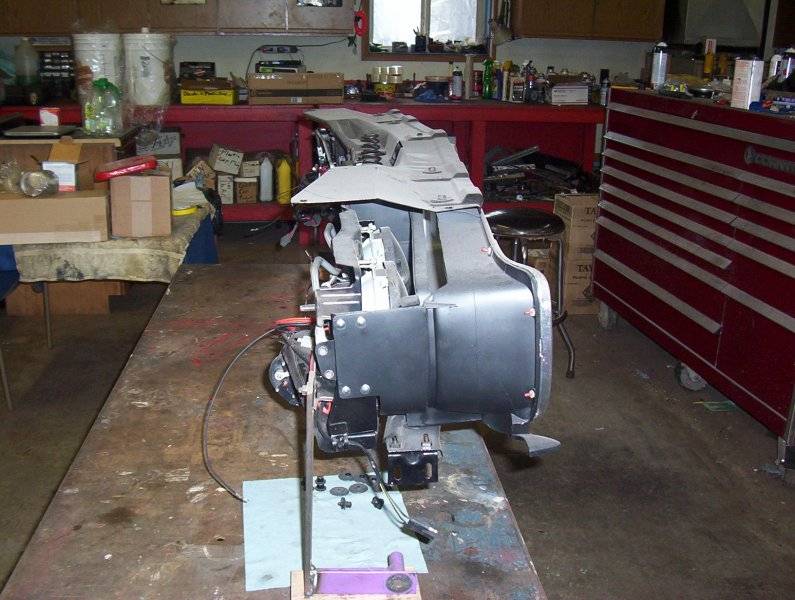

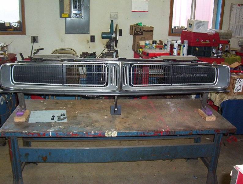

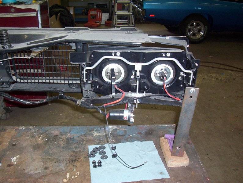

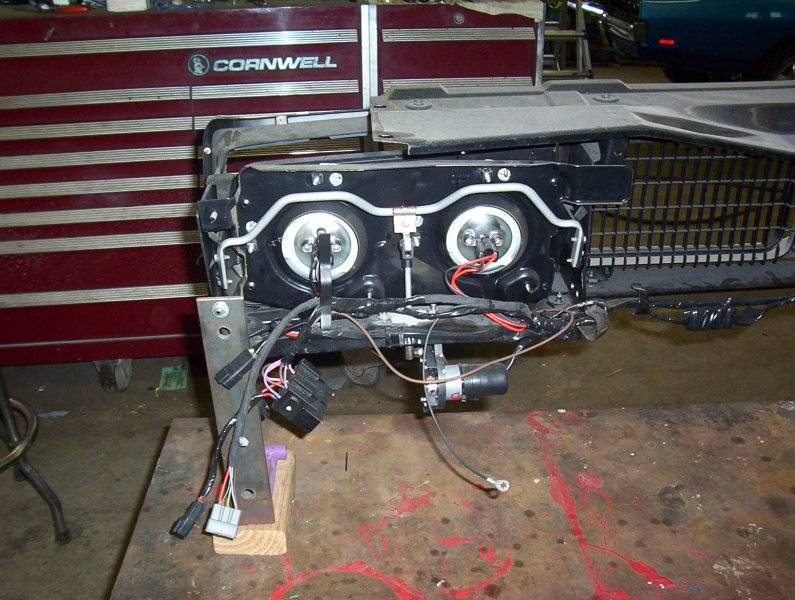

That's not easy. You need to get back there and be able to remove the 4 screws that hold a round bar hoop to both sides of the door. Then you might be able to somehow squeeze both sides of the doors towards the headlamps and get the door off the pivot pins. That might work. Remember the doors are old and very brittle.
Here is a picture of mine when I restored the grille and converted to electronic actuators.
I can see the 4 screws in your pic (the silver colored bar on the top?) looks real tricky and not a lot of room to get screws on the side closest to the fender. Is there any way to get the emblems off the left grill while it's still on the door attached to the grill ?
