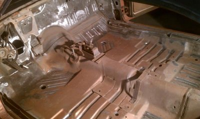

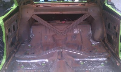

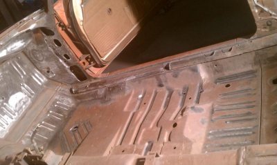

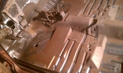

Well I spent all day yesterday stripping the interior getting it ready to paint, (figured I should do this before the engine's in otherwise it'd be a pain in the @$$ to tape off the firewall) and it's pretty awesome the original floor pan is still in this kind of condition after 45 years, cleaned up really easily
Not much process to detail here, just started with scraping all the old seam sealer with a paint scraper and the biggest flat-blade screwdriver I could find. (the screwdriver works really well in the covered channel by the door sill where the wiring goes through)
Started with the firewall and just used a corded powerdrill with a standard coarse wire wheel. All really minor surface rust that came right off so I got as much as I could with the wire wheel then hand-sanded the hard to reach spots with 180 grit sandpaper. Used the same method throughout the car, just hitting the low spots and any surface rust with the wire wheel and scuffing the rest with 180 grit.

I can see the brown boogers now, hope your not planning on eating them haha. I don't envy you, that had to be a mess wire wheeling that all off. That's awesome your floor is that solid, one less thing to deal with. Moving right along
Lol not too many brown boogers this time, I learned from past experience and got pretty well suited up: goggles, gloves, respirator, earmuffs. Ladies love the goggles haha :icon_cool:

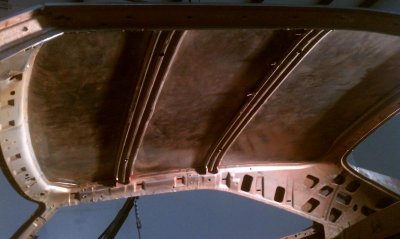

Some decent surface rust on the inner roof skin
So I ditched the little 3" wire wheel for this big @$$ cup wheel lol. Made things move a little quicker
Cleaned up nicely, almost ready for some paint :occasion14:

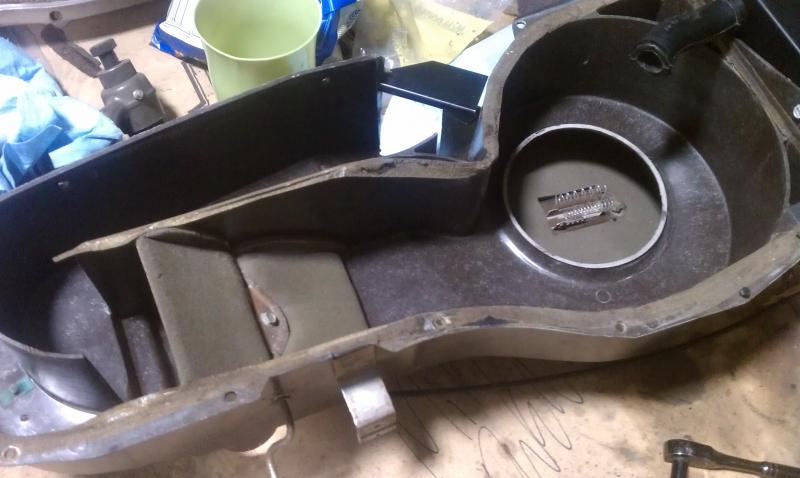

Took a break from the interior prep last night to clean up a couple of things, distribution block for my brakes, engine and transmission mount hardware, and my heater box. Speaking of things being in good condition, believe it or not this is my original heater box with nothing more than a wipe down with water and shop towels :icon_scratch:
Just a super light bit of surface rust on the back that comes right off with scotch brite pads. Aside from pulling the heater core for pressure testing, I'm just gonna finish scuffing it up, give it some flat clearcoat and call it good

Not sure if you had planned to do this or not....but it would be a great time now to pressure test & flush that heater box radiator before it goes back in the car - much easier now that it is on the floor. :glasses10: looks in excellent condition...in fact the whole car looks way better than the '69 Charger I had many years ago.

Yep I'm planning on pulling the core for pressure testing, definitely a lot easier out of the car haha

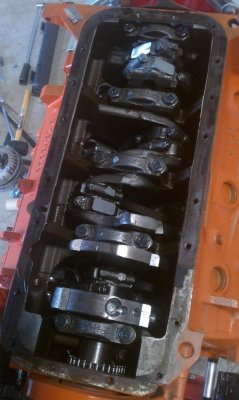

Alright guys, finally an update. First off I guess I'll start with the good news, when I bought the car the previous owner told me the 440 had been rebuilt and supposedly had a good cam in it "hottest 440 car I've driven." He also said "the body is ready for paint" so I didn't necessarily expect it to be true, but when I cracked it open last weekend to do the rear main seal I had a pretty awesome surprise
Brand new pistons and rods, perfect bores, balanced crank, double roller timing chain (chain is super tight), brand new aftermarket cam, arp hardware, basically a brand new engine :icon_biggrin: Between all that and how nice everything was under the valve covers, it seems safe to say there was some headwork done along with the bottom end. Seems like everyone that's selling a car has a "fresh rebuilt motor!" but it looks like I got lucky on this one

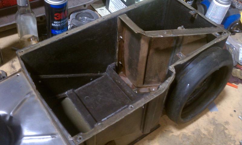

Other than that I've been keeping pretty busy. Took my heater box completely apart and cleaned it all out. Also noticed the outlets for the heater core were bent pretty bad so I straightened them and pulled it for pressure testing. Just had one leak at the outlet, got it re-soldered for only $10, good as new. Otherwise just sanded and painted the rusty pieces the vent cables attach to and back plate with martin semour underhood black. I might do a better step by step post on all that if it'd be useful to anyone

Good to see the engine is a good one, :iamwithstupid: nice to have an unexpected surprise like that & save a few bucks here & there...
