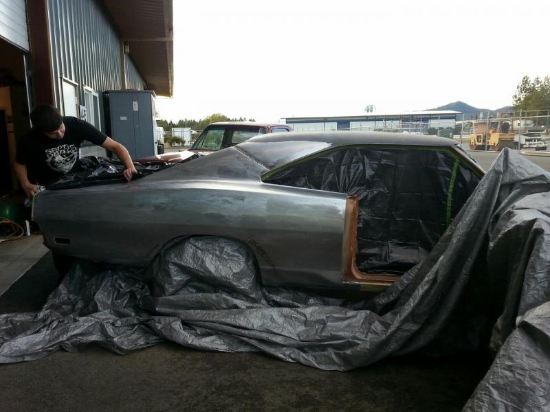

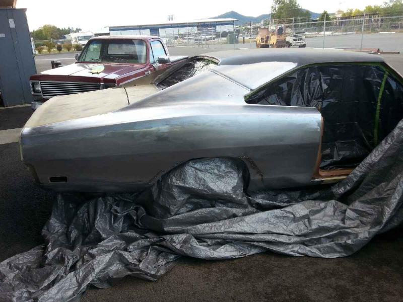

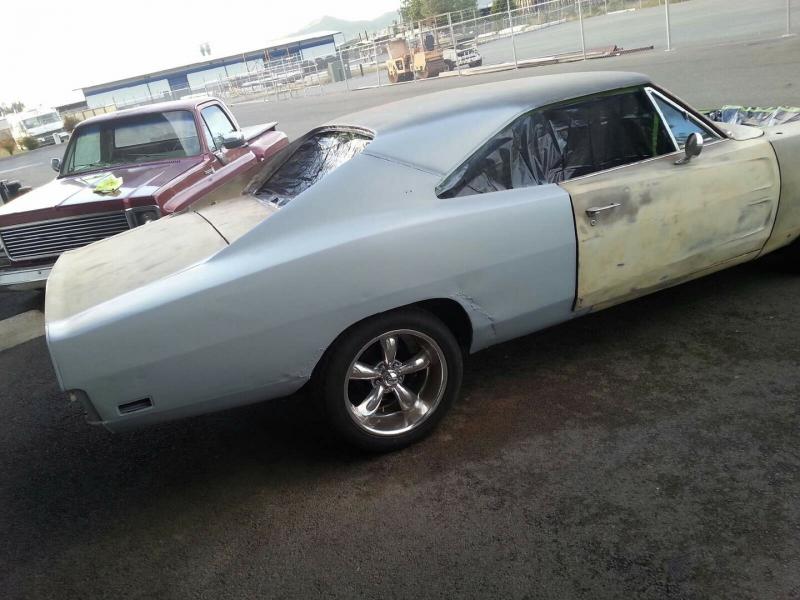

Ended up deciding to strip all of that crappy filler primer and everything off the car to start my bodywork with a clean slate and save myself from any surprises down the road. Started with the passenger side quarter
Then etch-primed it for protection in the meantime until I finish my grille. Also just a note this side I still have to do a lower quarter patch on forward of the wheelwell, where the thin warped metal is. More fixing previous bodyshop sins.. :banghead:

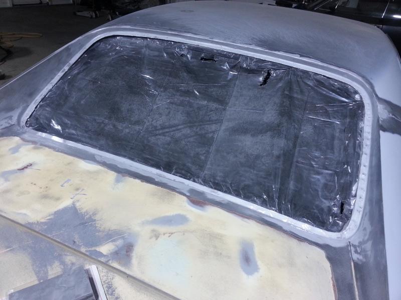

Working around the back of the car, I took the wire wheel to the rear window shelf and laid down a smearing of All-Metal to smooth out the grinding. Started sanding it down in this pic

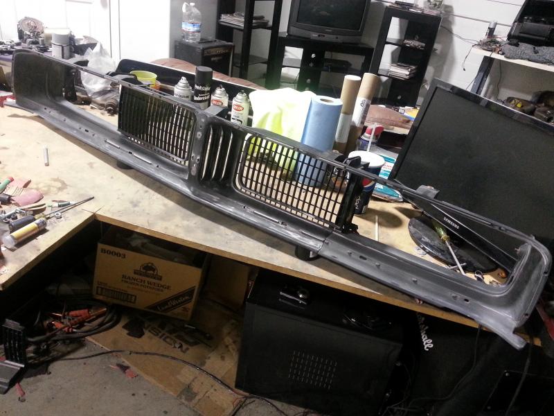

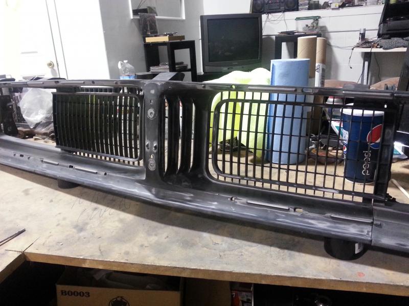

So I've been switching between a few different things but this has been the main focus lately, finally got the plastic sections of my grille repaired, smoothed out, and scuffed up ready for paint :icon_pray:
I don't even want to know the number of hours I have in just these 3 pieces.. went a little ocd with making everything as close to perfect as I could get but I think it'll pay off, and once it's painted you shouldn't even be able to tell I pieced in that large part of the "finned" section on the right side. Surgery was a success haha

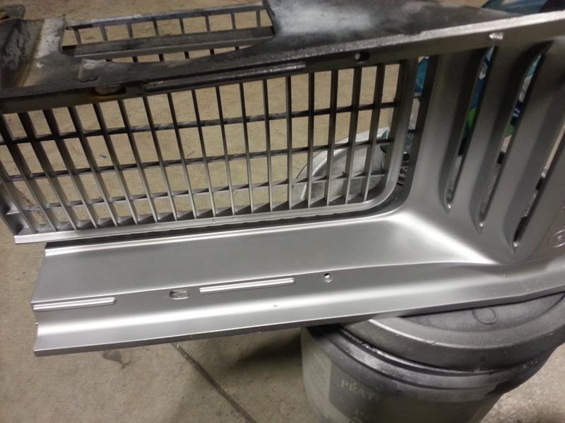

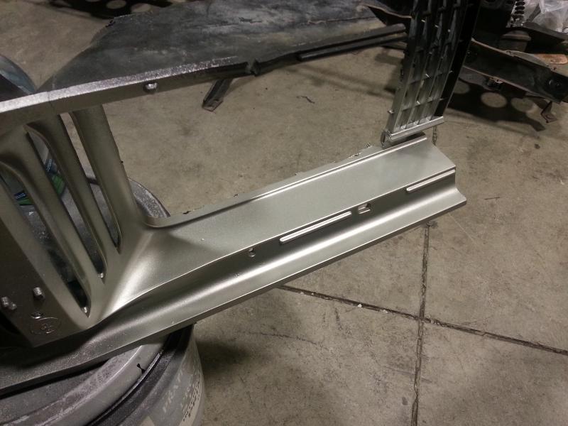

So here's the issue I have now, I bought "matte aluminum" krylon to try for the silver in the grille, but when I tested it on my donor center section, it came out just a shade lighter than I wanted and a little too reflective I think (?)
I've heard "Argent silver" and some kind of silver wheel paint mentioned but does anyone have a suggestion for what to use??

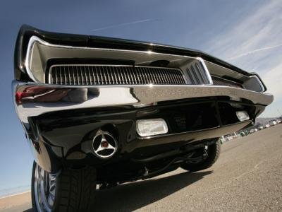

I think I'll see what I can dig up at the local paint/body store after work and if nothing looks right I'll pick up the Eastwood argent silver. For what it's worth this is the exact silver I'm trying to go for:
Don't know it's the same shade but 5.7 recommended for the dark argent and he's know's his grill resto's.
From what I understand, Totally Auto is the only place that makes the correct textured dark argent paint. It is pricey, 24 bucks a can!!!

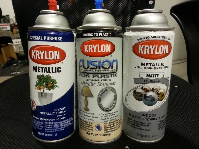

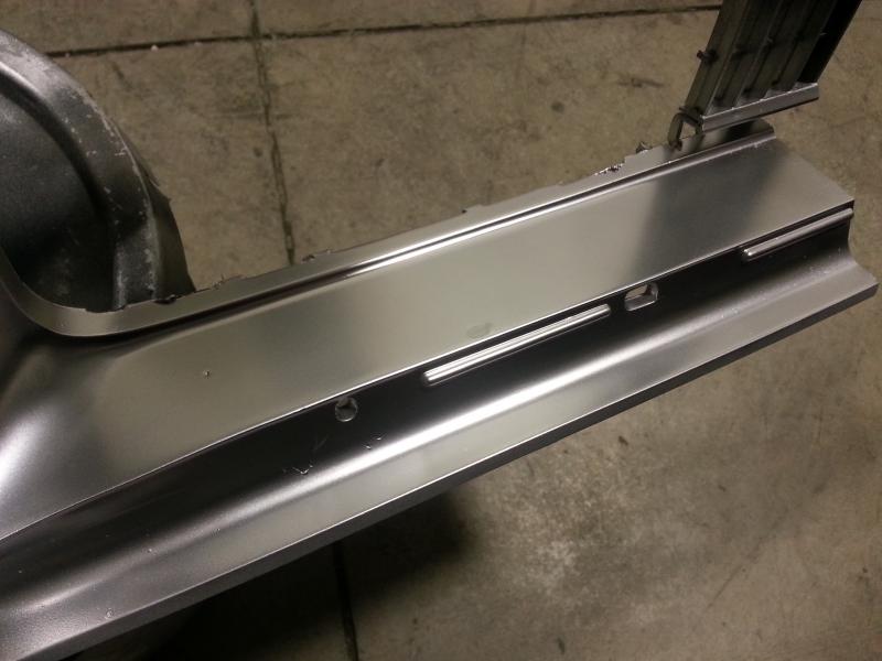

Well it looks like we got a winner fellas, I talked to my friend Mike that does restorations and got it all figured out. He originally told me to use that matte aluminum, but I bought the wrong one, "metallics" line. The one he meant is Krylon #1403 "dull aluminum" that's only available in my area at Ace Hardware. Tested it out and it looks just about perfect to me, what say you guys?
The only downside is this one is pretty thin and shows everything so I'll have to go back and do some wet sanding with at least 400 grit before paint. I liked the nickel finish too, but the one I got was some "shimmer" paint that had too big of metallic in it for what I wanted, didn't really notice til I looked at it in the sun. The "dull aluminum" one still has some metallics but is the least reflective out of the ones I tested, and I think is a shade darker than some of the other argent silvers.
And thanks for the offer anyway conv67 :icon_thumleft:
And I should note, I wasn't too worried about being 100% factory correct in this case, but Mike told me that paint is a dead ringer to the factory silver on a lot of mopar grilles. He had just used it on a '68 Dart grille and mentioned it also being used for the inside of '71 'Cuda grille and fender "gills."
Here's what the cans looked like of the 3 that I tested, "dull aluminum" on the left, "nickel shimmer" in the middle, and "matte aluminum."
