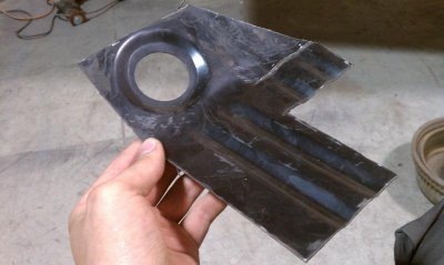

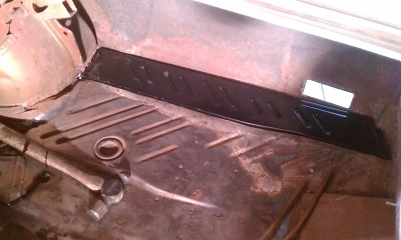

Well last weekend went well, waiting to borrow a friend's mig but I cut out and shaped up my patch for the rot in the corner of the trunk.

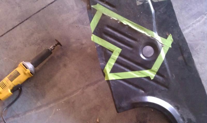

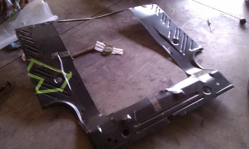

Mike was nice enough to give me what was left of a complete floorpan from a Superbird he built, didn't have the spot I needed but I was able to cut shape a section to make a pretty damn perfect match, I don't have much experience with metalwork but I'm really happy how it came out, can't wait to weld it into the car :eek:ccasion14:
What was left of the Superbird pan with the section outlined I decided to use to make my patch

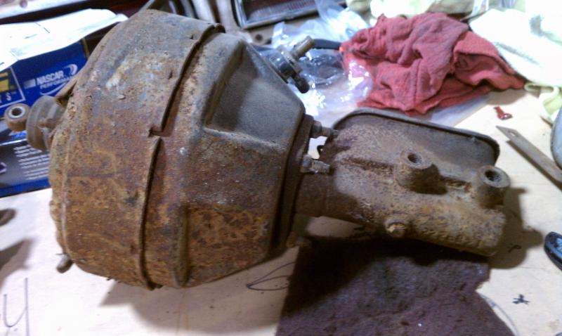

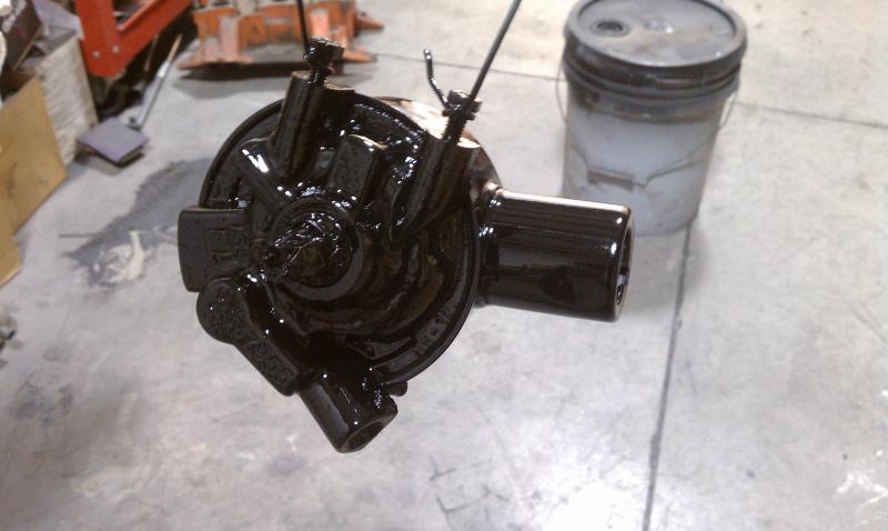

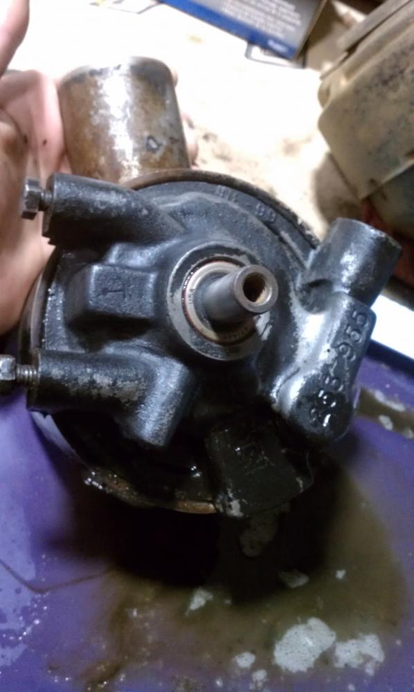

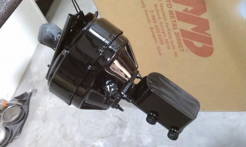

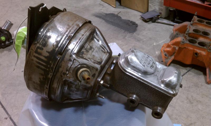

Also finished cleaning up and painting my brake booster/master cylinder and power steering pump which both came out nice. Pretty cool before and after shots

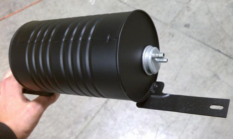

If you have any use for a really nice vacuum canister let me know. My dad made me a stainless one that mounts under the fender so I won't be using it.
Whoops, there we go those pictures should show up now.
Oh that's cool, a stainless one would look great. I actually just restored mine last week

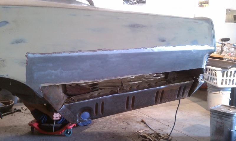

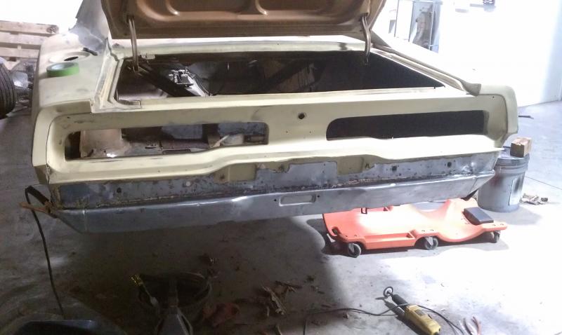

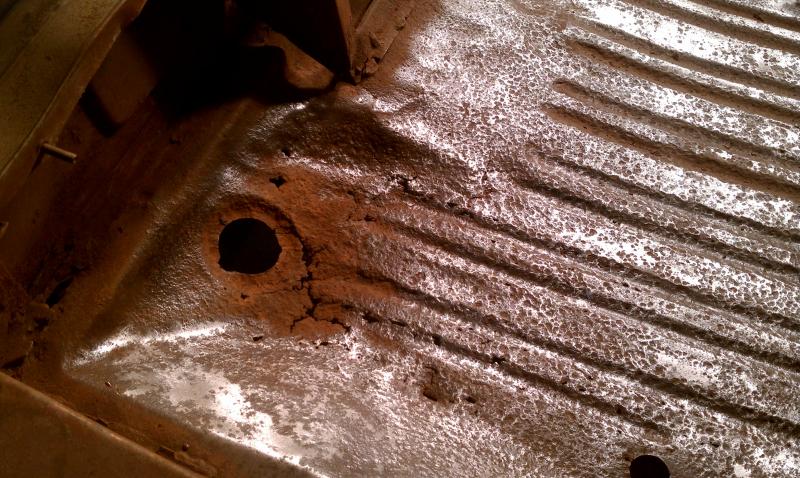

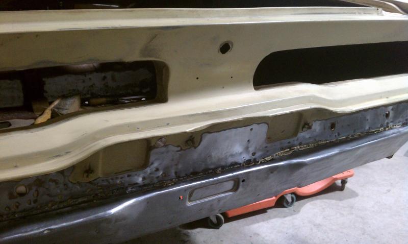

Well it was a long weekend but luckily no emergency tetanus shots. A friend of mine came over Saturday and we ended spending most of the day just getting the old rotted trunk extension out and chopping out the rest of the cancer we could find. (turns out the infamous body shop just threw the passenger side lower quarter patch right overthe top of the rotted quarter) :banghead:
So then came a solid few hours cleaning up that and the rest of the crappy areas around there and getting the new trunk extension fitted. But as it stands now everything is stripped, sealed, fitted and prepped so the surgery can get wrapped up this week. :eek:ccasion14:
Fits like a glove.

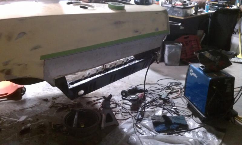

First rough cut made on the drivers side quarter, bodyline taped and final cut line marked. Also stripped and sealed the trunk extension on that side to keep future rust from having me tear everything apart again.
And used the random hole in the tail panel behind the rear bumper as a spot to get the welder settings dialed in and ended up patching it pretty nicely.

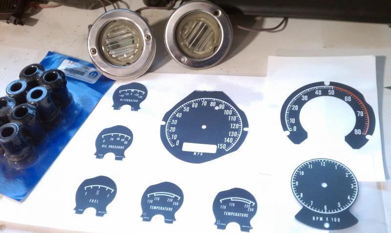

Didn't get much done yesterday because of it but made a pretty fun trip to a town about 45 min away and paid a visit to a friend of mine that used to make mopar reproduction parts, really nice guy and knows these cars inside and out. (same guy I bought the spindles and brakes off his '70 hemi challenger) He still has original parts laying around and can get basically anything I could need, so I picked up a couple parts for a really killer deal :eek:ccasion14:
Leafspring bushings, new gauge face decals and finally an awesome pair of reverse lights. Luckily he has a drivetrain-less General Lee on display in his front yard and was nice enough to make a template off it for me to mark and cut the reverse light holes on my car.

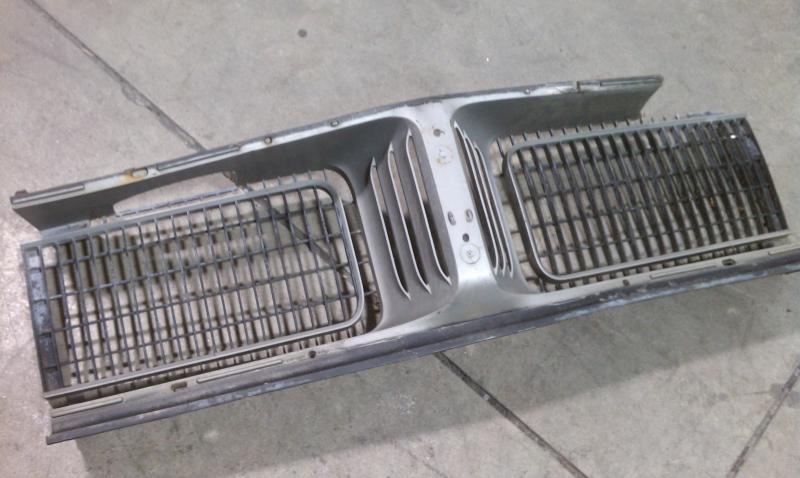

And another awesome score, an almost perfect center grille section he had laying around. Haven't decided yet if I'll repair this piece or my original one, but a good find either way

Weren't the reverse light holes already stamped in yours? Does your friend sell the gauge face decals?
Nope, the car took some kind of hit to the rear drivers side quarter early in its life (new quarter was brazed on) but they used a '68 quarter and tail panel as replacements so no reverse light holes and that stupid *** plasma-cut marker light hole I'm dealing with fixing. lol
And yeah I think so, you need a set?
