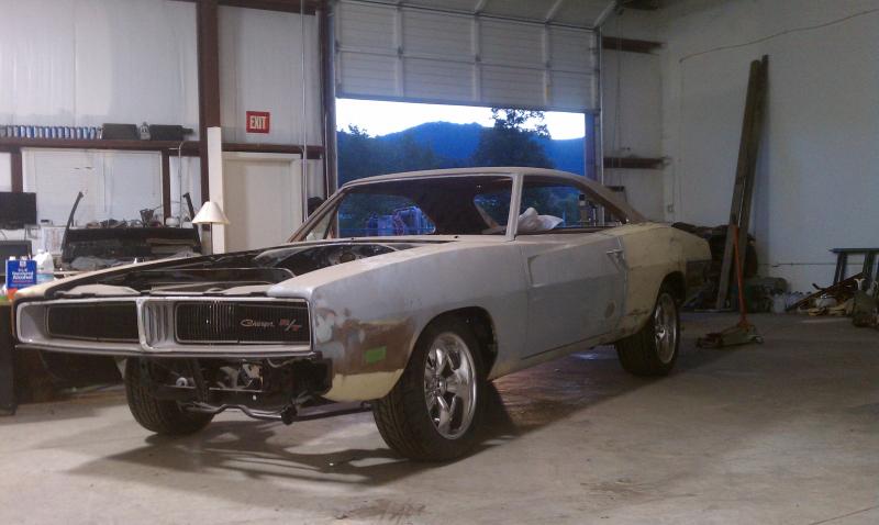

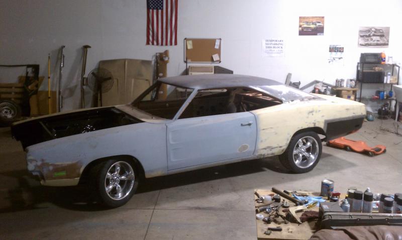

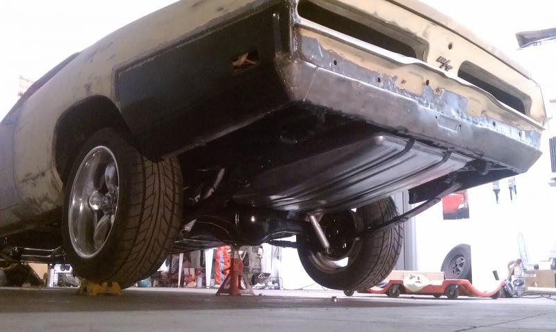

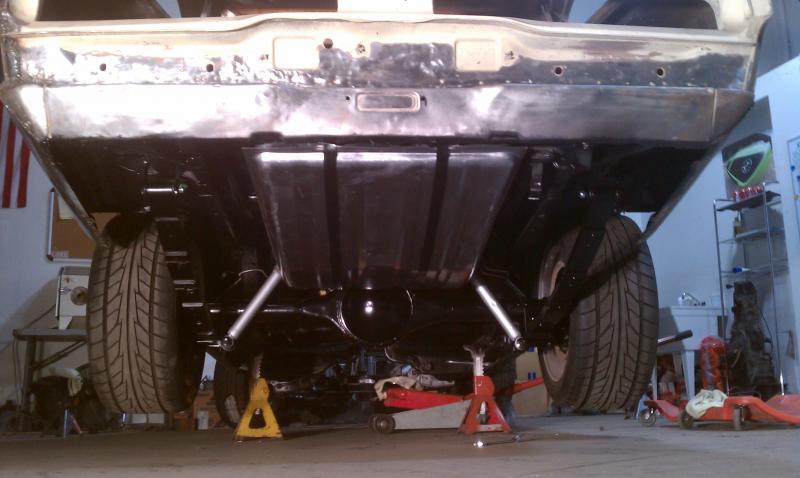

Well last weekend was a big one, stayed up all night Friday night getting everything under the car reinstalled and buttoned up. My previous pictures of the car rolling were with the front spring hangers unbolted, so aside from the spacers still not being installed yet this is about the final fit for the rear wheels
:icon_cool:
Sunrise after a long night

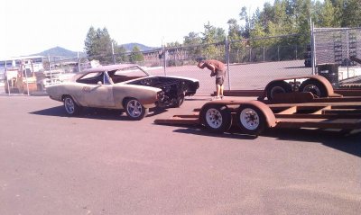

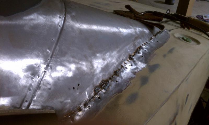

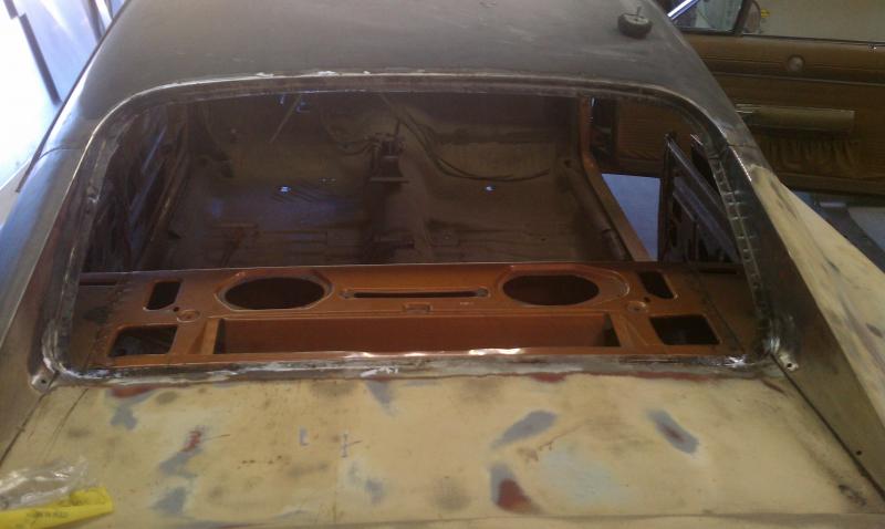

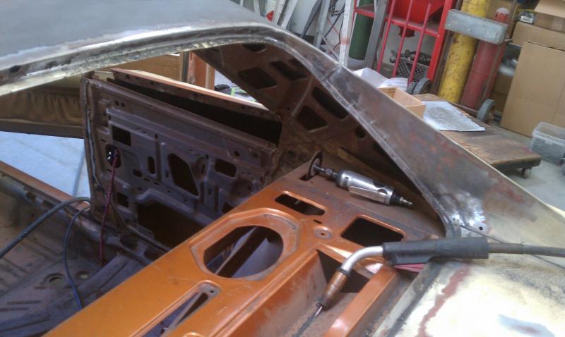

So the point of the all-nighter was to get it back rolling for a field trip to my friend Rich's shop to get the rot around the rear window taken care of, so another long day after a long night, but definitely worth it with how well it came out.
My dad checking out the wheels haha

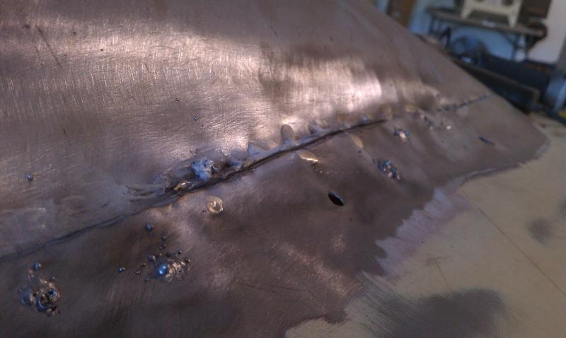

No more rot! :icon_thumleft:

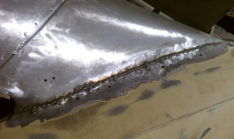

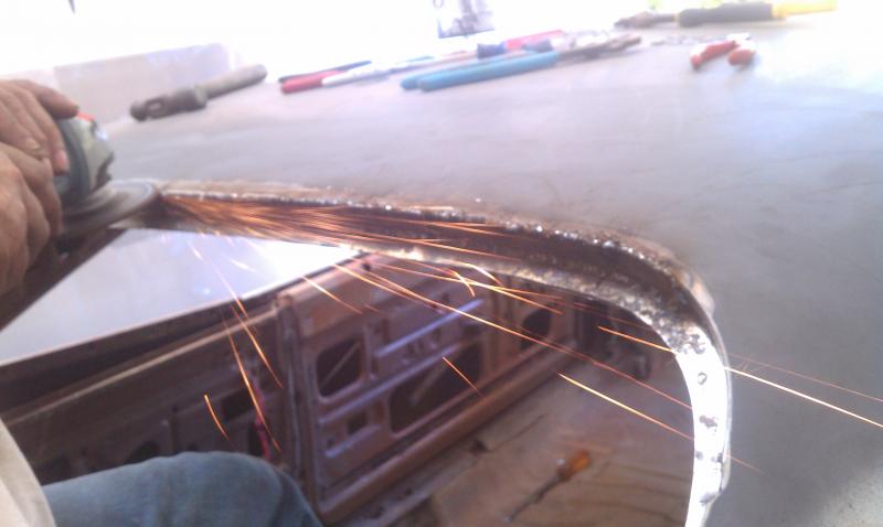

And finally a cancer-free rear window surround
So we ended up only patching the "face" of the surround (between the shelf the window sits on and the roofline itself) since the window shelf was in good condition and I worried about the window and trim fitment if we were to add more thickness to it. Some quality time with the angle grinder and roloc wheels and it came out looking great. Still feels weird not seeing the whole thing rotted out like it's been since I bought the car lol
Finally back home and cancer-free!

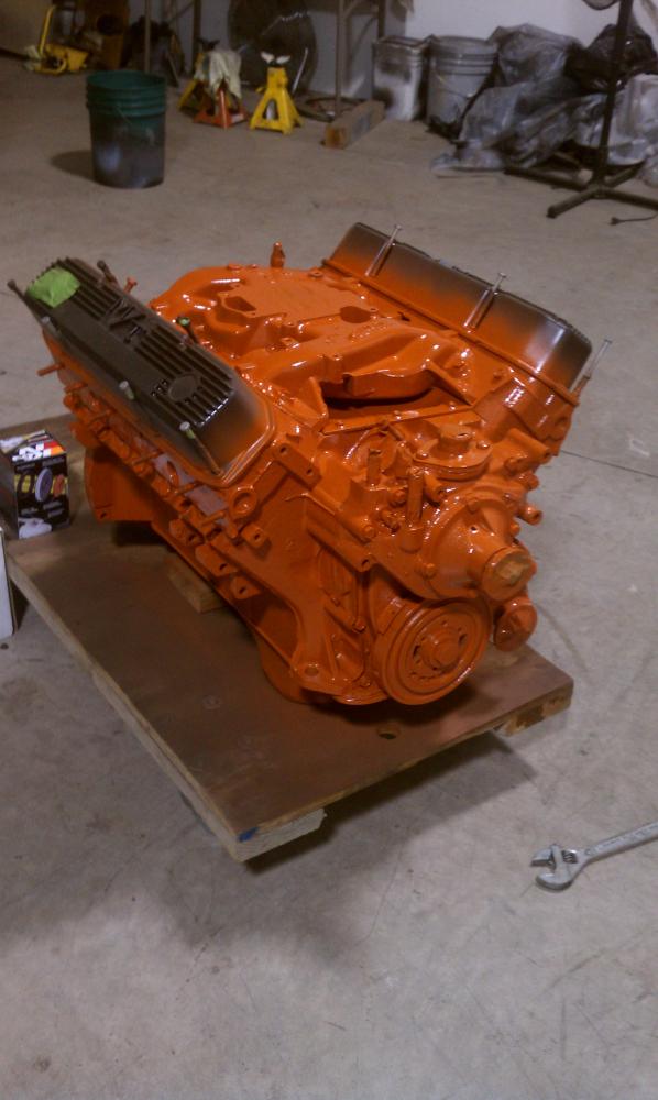

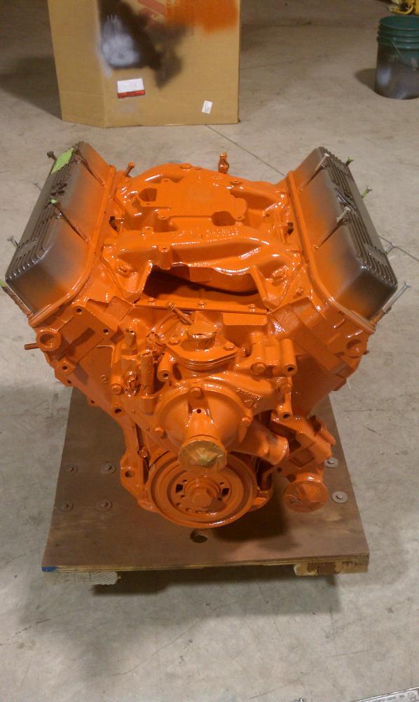

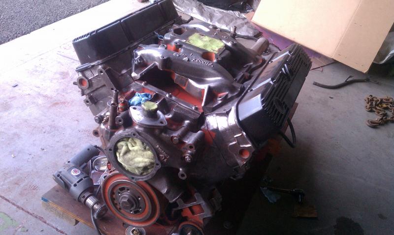

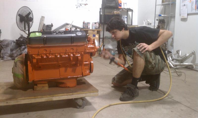

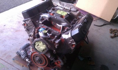

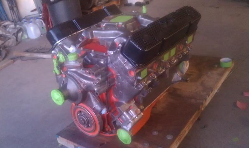

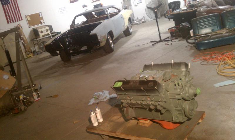

And I'll post some more pictures tonight, over the time I was MIA on here for a bit I got my motor disassembled and stripped with some wire wheels and my power drill. Got it taped off and etch-primed last night, and shooting it with factory-matched orange when I get home :icon_cool:
