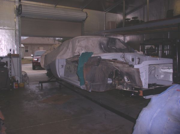

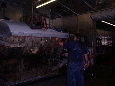

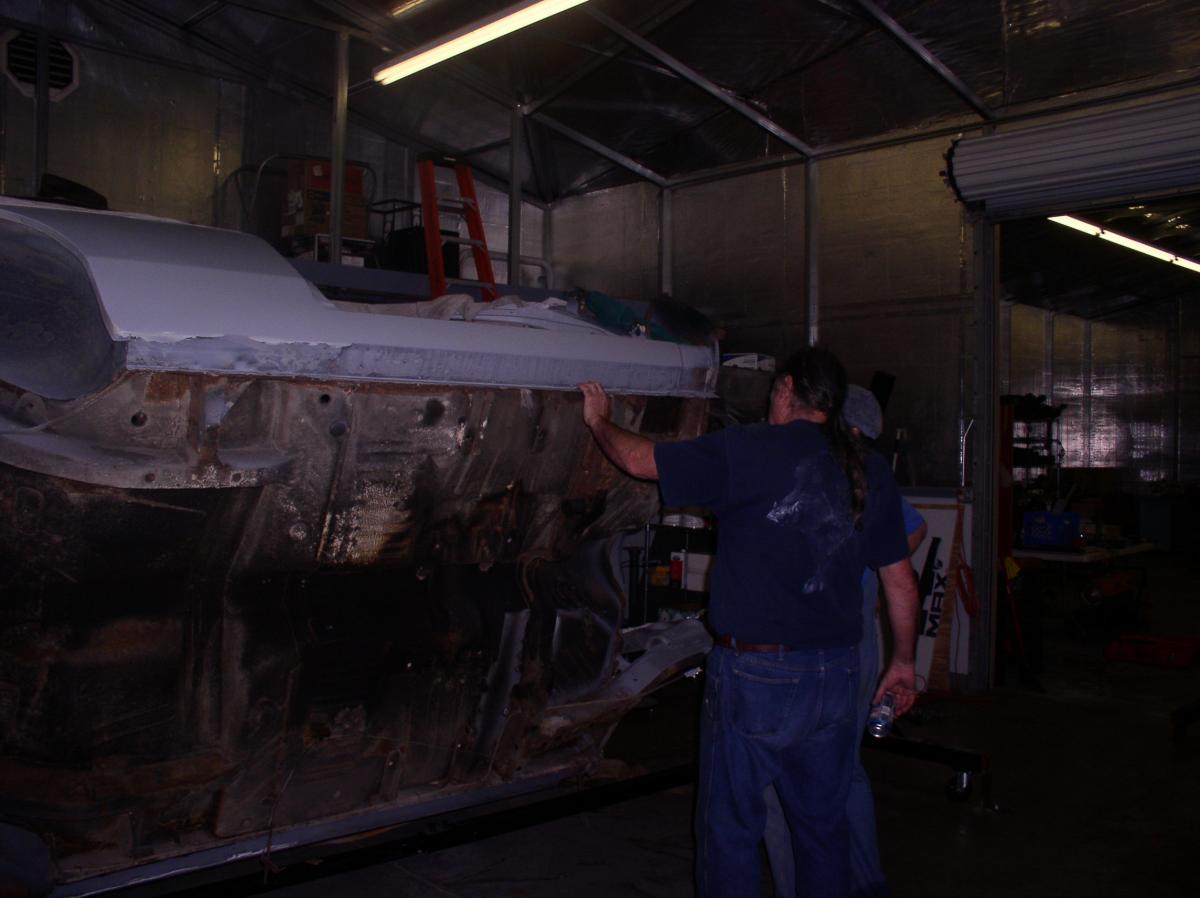

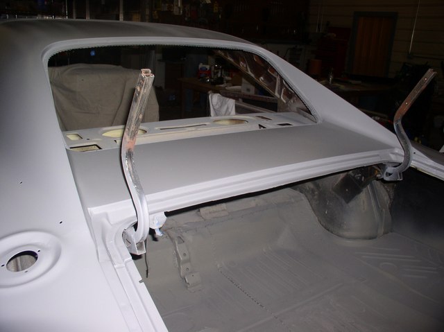

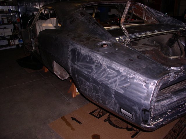

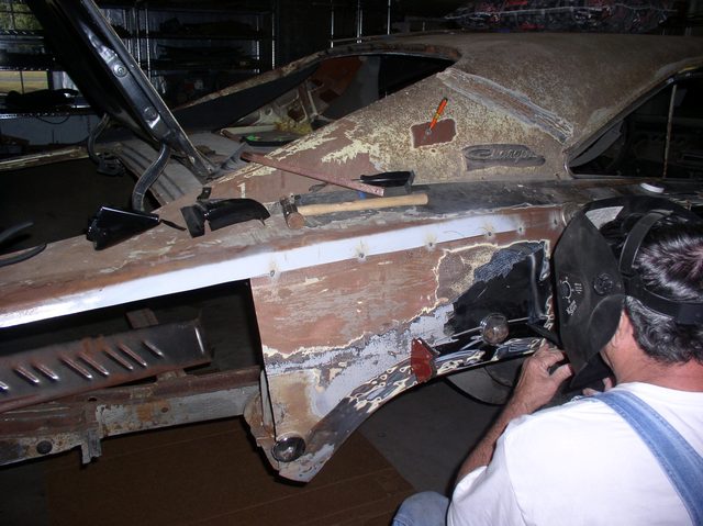

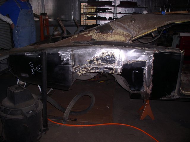

Progress from 2 we-ain't-bodymen.

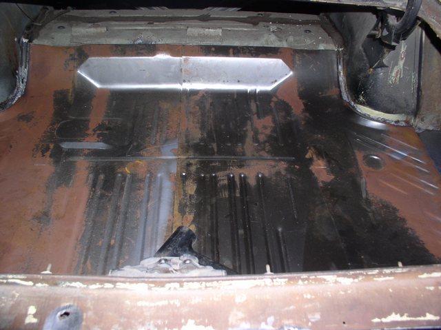

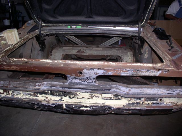

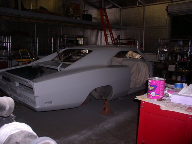

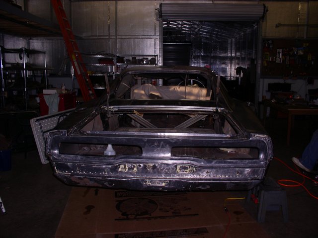

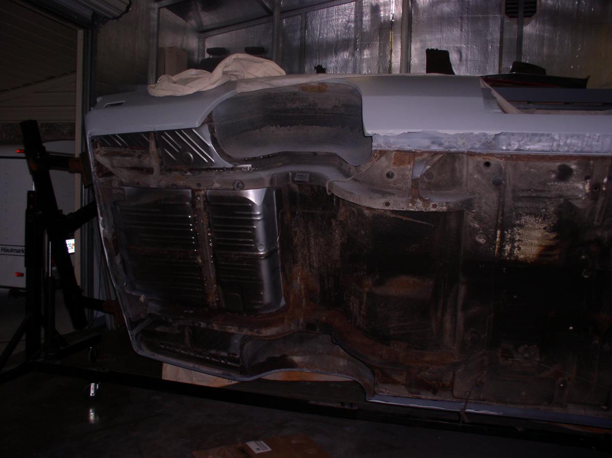

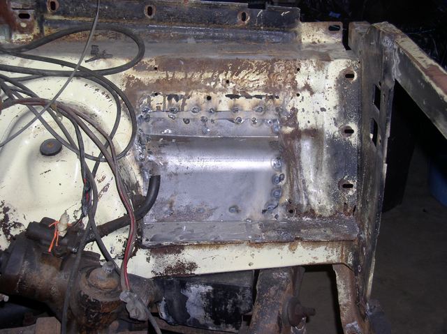

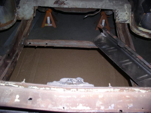

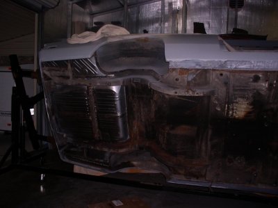

Thanks, it is my buddy's car, and we need inspiration. This heavy-duty body work by us newbies is hell. We read up(we thought), and cut out the old rot; cut the replacement 2" bigger, screwed it on the car. Then took a die grinder with a 5/64" thick disc, and cut through both panels at the same time, putting butt welds in as we went. WRONG. Use a thicker disc, even jumping all over, and using wet rags, evidently the gap was too small. After the warpage, read that welds contract when cooling, and the metal had to move- our problem. So we cut out some welds, and hammered back in, re-welded. Crapola.

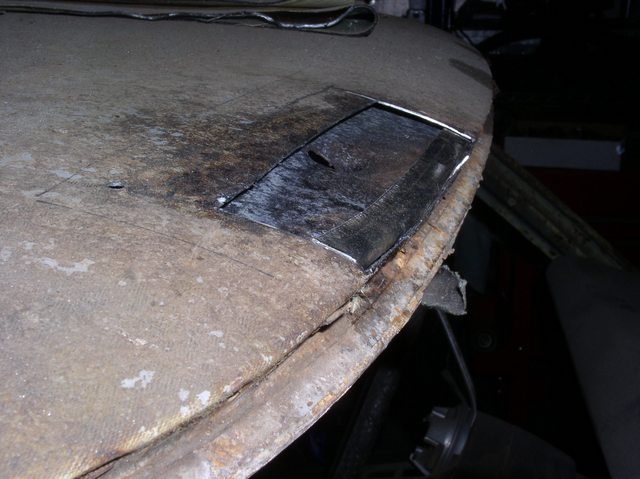

AMD is almost perfect. And a Hobart mig (gas) with infinity dials kicks a Hobart flux wire's butt. And using a torch, and wet rags will help, but only on a small oil canning area (learned that on the rear deck; cut slices, heat/cool; got some out. Took a big hammer, heated, and smacked it down until no more oil canning, then welded the slits back up).
Neophyte country boys, but it is working. (can't wait for the gurus to pop in here, as they weren't any help. Wrong phrase; the" gurus" that only want a post count.).
Your friends are: 17" air body file, 3m paper from 45 to 220 grit (Norton kept clogging), The Harbor Freight discs for a grinder, just for welds(looks like a flapper, but on the face $5), ospho ($17 at Ace Hardware), a heated shop ( kerosene torpedo from Home Depot), and massive amounts of beer.
Keep it up, man! I'm diving in headlong right alongside you, as you can see in the post "My 68 Charger restoration." The more I uncover, the more I find. My dad came along today and said, "Geez! I didn't see all that! If you ever get this back together I will be beyond impressed." Thanks for the vote of confidence...
Try using a can of heat sink putty, kinda like Playdo, make a snake out of it and place around the area you are welding. It is reusable and does help with the warpage. I got mine from local welding supply.
The most important thing is to just tack and dont do it right next to the other one . Jump all around and just tack until finally you have the whole thing welded. Take your time and you shouldnt have that much warping. The best way to get it straight is to sand it manually with a long board. Its a ton of work but it will be as straight as the time you put in it.Keep up the good work and keep us all posted!
Nice work! I am a body beginner as well! So this is very inspirational! Also backing your welds w/ heavy copper/brass plating reduces warping that I can see and allows for a nice bead puddle. Eastwood sells the welders helper kits for a reasonable price that comes w/ everything u need.
