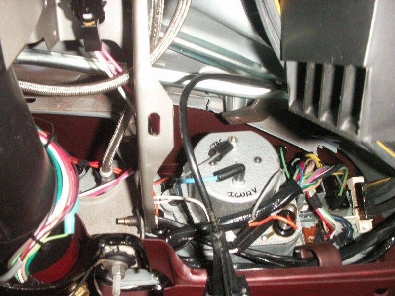

For example, I see this photo-
And this one-

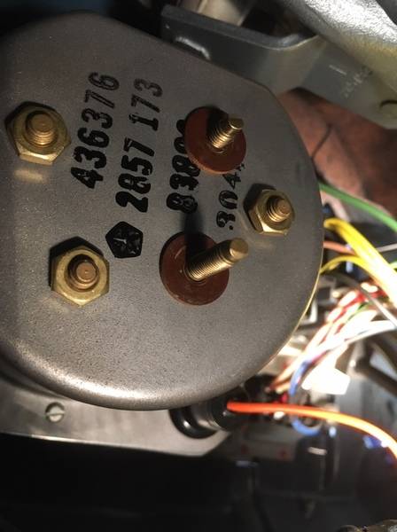

Here is mine-
Any idea which way is correct? Maybe this is a difference between original and reproduction? Not sure but don't want to fry it so any suggestions are appreciated :)
The tall post is 12v power....The short post is for the coil wire.....the ground is the housing to dash frame...
+12V comes from the fuse box? My tach was wired like this (aftermarket).
