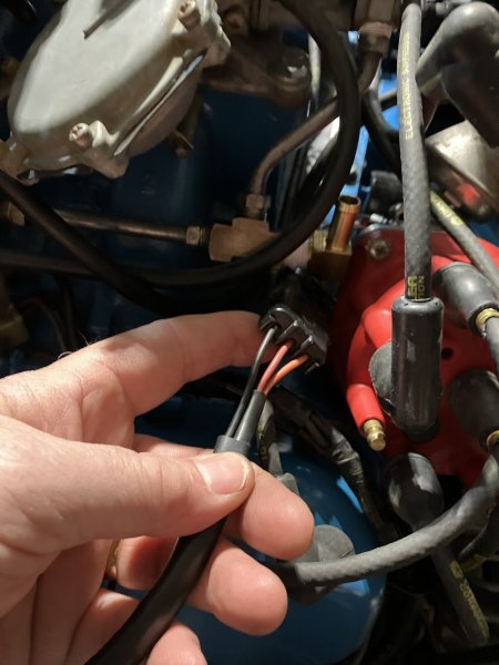

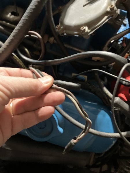

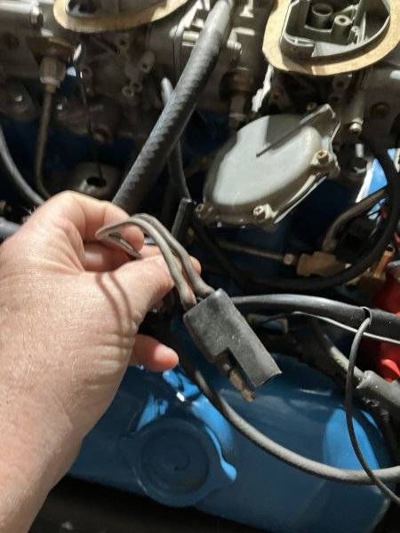

So I have kind of an interesting setup here with what appears to be a completely stock ignition setup with the exception of an MSD distributor cap. The first two pictures show what is not hooked up from the factory wiring harness. The third picture shows the two wires from the factory harness to the coil that are hooked up. Shows a black/yellow strip wire to coil ground. I also have the orange wire from the msd cap going to coil ground and also the red from msd cap to plus on the coil.
I currently have no spark. I see around 4.4vdc at the coil with the key in run position. From reading through several threads, I guess the 4.4 is not enough. It was mentioned in one thread I should focus my effort at the bulk head first? Let me know your thoughts on this if you could! Thanks! We are getting closer to first fire!

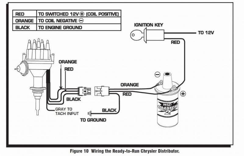

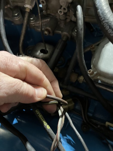

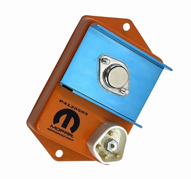

Trace this wire back and I bet it goes to either a Orange/Chrome or Blue Mopar ECU. If that is a RTR distributor you wont need to use that. Wire it as the above picture shows.
ECU looks like this.
Couldn't be a simpler setup. Just need to pull the run power AND start power together as a feed.

I am finally back on getting spark to the dizzy and although this is supposed to be simple I need a bit more input here. I was reviewing this topic and I just now saw that becuase I am running the MSD RTR I would more than likely need an aftermarket coil correct? Basically the one shown in the picture above, an MSD blaster.
Second, I also just realized if running this MSD Dizzy, I would also need to wire the ign 1 and ign 2 together as Rem mentioned. Does this remove the ballast resistor from the picture? Thanks!

Yes.
Mike

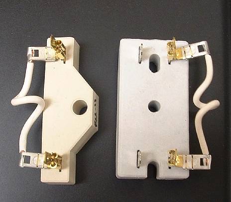

Or a basic jumper wire between ballast prongs.

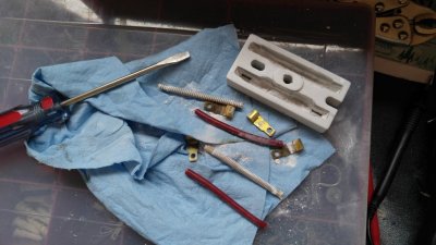

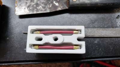

Or remove ballast, modify it removing resistor from rear groove and replace it with a wire, so the jumper will be hidded.
(Just in case want to get back to stock so won’t have to reverse any wire mod, but just replace the ballast)
