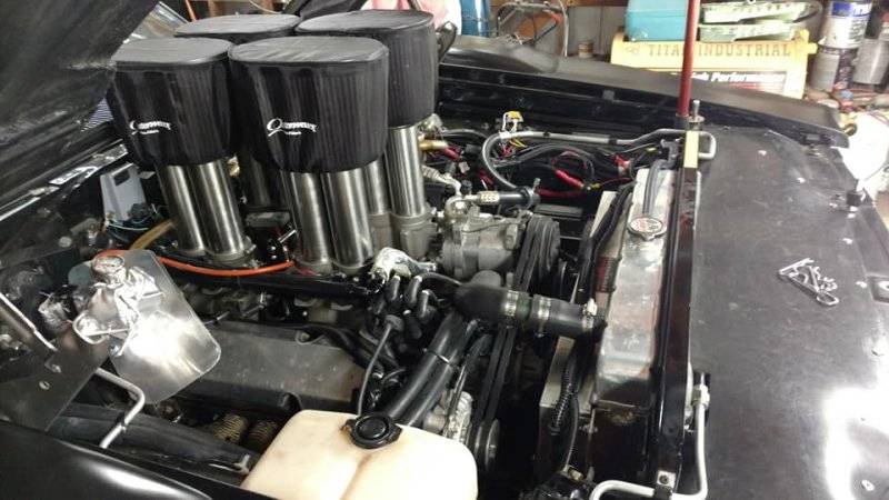

I use EFI & have a Lokar kickdown cable. I recently added a spacer under the throttle body due to some heat issues & having a dual plane intake, so raising it up put off the geometry of both my throttle cable and kickdown. I purchased a really nice hi-rise bracket on eBay from Richard Ehrenberg that solved it and it accepts a Lokar style kickdown, so no longer required the separate bracket. Dunno if this bracket may help but thought I'd throw it out there.
Bouchillon on my junker
