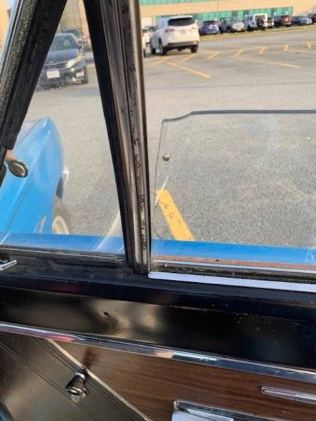

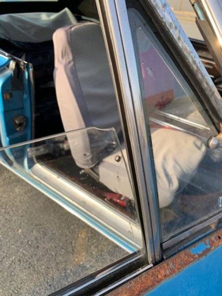

I have a 69 Sport Satellite convertible. Are the door window channels the same as a hardtop or are they convertible only? I need the piece that runs along the rear of the vent window trim. It locks the window in and stops the rattling. Are these readily available? I have pics showing the window leaning back out of the channel. Thanks for any help.
Slider felts/mylars would be the same, they are longer than needed and get cut off.
https://www.forbbodiesonly.com/mopa...ge-super-bee-coupe-restoration.145777/page-38
Post #757 onward shows, pretty well, what you're up against. I highly suggest you find some OEM mylars as they are formed curved to match the glass.
@69bfan Richard can probably help you source some good ones, the straight repros are only good for coupe rear flip out window use.
