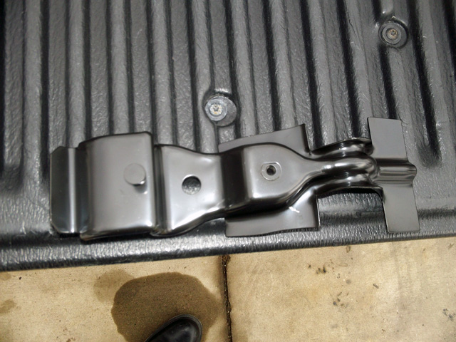

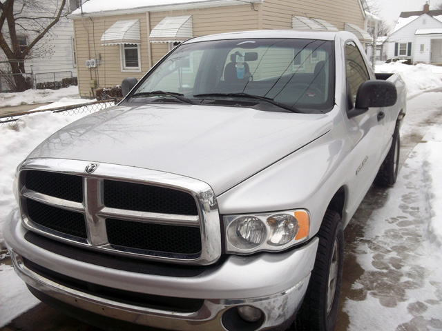

Look what I got today.
A new truck! Well, new to me. It's a 2004 SLT 4x4, power everything, and a tow package. This is the first time I've ever owned a truck. I've had SUV's and station wagons that I treated like trucks but never a truck. I guess this means I won't me strapping new body panels to the roof of my car anymore :) . The only problem with it is that it's silver. This is four cars in a row now that I've owned that were silver.

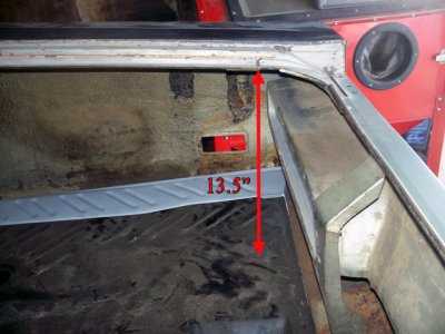

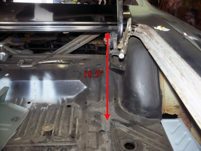

Hi guys, I need to ask another favor for those with a 69 Coronet. I'm bracing for quarter removal and just want to double check what I have with another car. So here's what I have and if someone could measure their car at the same points I would appreciate it.

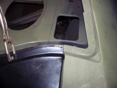

And in my quest for power and glory I forgot one small detail........(Lets see who gets that quote), I forgot to do great measurements. Actually I was in a rush to get my back window done before the snow hit last fall, and I didn't get the corners right. I didn't have the dutchman panel when I installed the corners and now I'm paying the price.
So now I get to pull it all back apart and redo it when the weather warms up. Live and learn I guess. :BangHead: Take your time and don't rush anything. Also don't weld till it's right. Screws would have been easier to remove than spot welds. :oops:

Bummer about the window corners man, but like everyone's said I'm sure you'll get it taken care of no problem. And I can check the Charger for those measurements but I don't know 100% that they'd be the same from 'Net to Charger :shruggy:
Thanks Speedy, I'm thinking that most 68 or 69 Plymouth's would work as well.

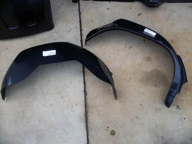

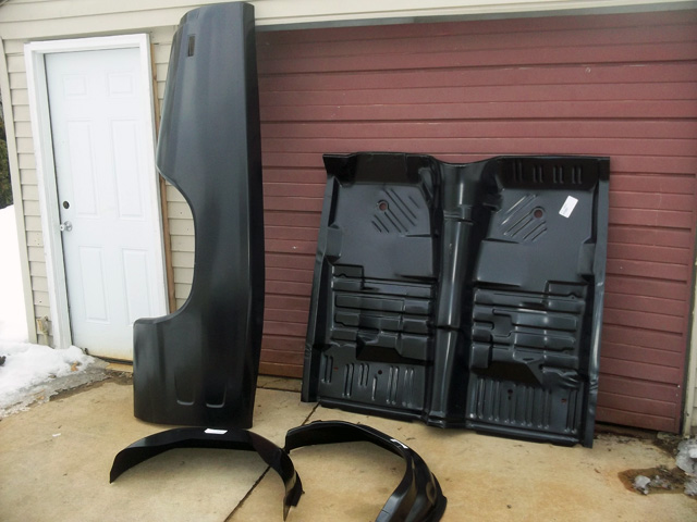

But on a different note I got parts today. This along with the repairs to the window corners should keep me busy for the summer. :) They didn't have the rear footwell sections in stock so I'll have to get them later.
Damn, that's enough to keep you busy for a while haha nice score! I checked those measurements on the Charger and good news, they match up perfect. :icon_thumleft: carry on with the sheetmetal surgery brotha!

Glad to see you got those parts in. will be looking forward to seeing a lot of pictures during the install.
