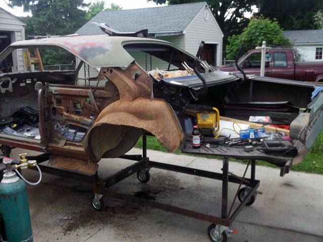

The weather here has been cooperating with some really nice days, so because of that the Coronet is looking a little less like a car now. I still have to clean up the edges on this side and then remove the other quarter skin. Once the quarters are off I'll remove the front cowl. When all of that is done there's just some small mechanical and trim to remove then off to the media blaster.

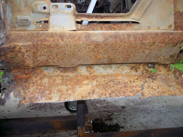

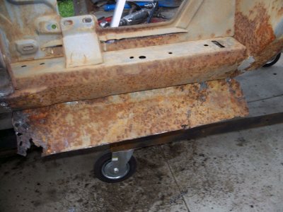

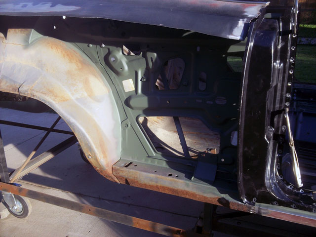

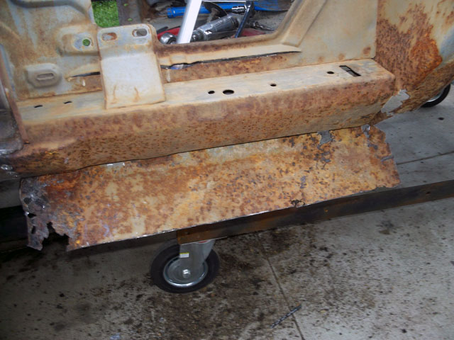

When I peeled back the quarter metal the outer rocker looks to be in good shape. I hope the other side looks as good.

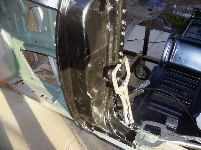

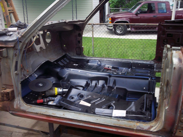

The floor is getting closer to going in, hopefully that will be the second thing once it comes back. The first thing being primer.

Agreed, looking really good. Your test fit looks really good with the floor and I imagine things will take off once primer starts going on. Keep it up

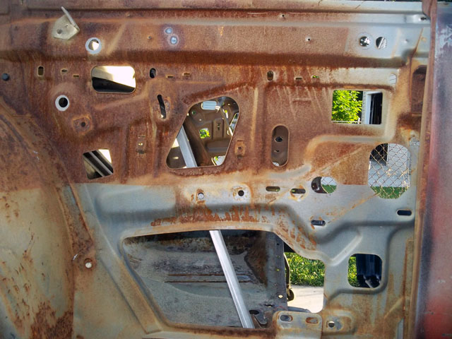

I've got to get my camera outside and start snapping pics because I have the other side tore apart and am going to start sand blasting the remaining rust. Never give up, never surrender. Do whatever it takes to make this car happen! Ok now where's my Twisted Sister CD for motivation.

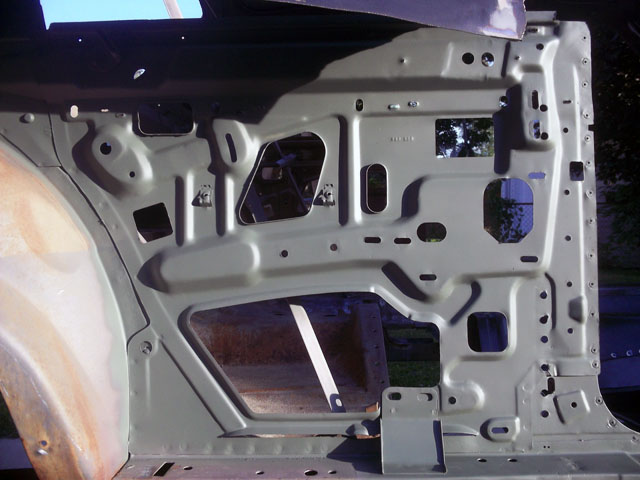

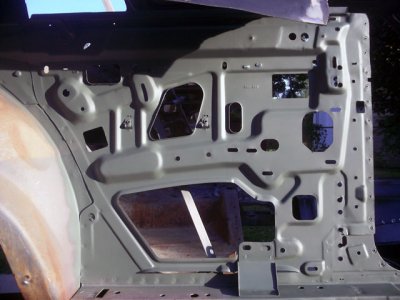

Today was a good day, I media blasted the inner window panel on the right side. I finally got the mixture just right, it's 50% silica and 50% iron oxide. In laymens terms that's equals start with a 50 pound bag of play sand from the hardware store. Blast the frame and all the rust on the car. Sweep up the mess and strain mixture through an old screen from the basement and keep blasting. Repeat until you have enough rust and metal shavings from all the grinding that it's now 50/50. What can I say...... I'm a cheep bastage. It did come out good though. I got is blasted, primered, and started fitting the new striker panel.

Whatever it takes bud! It sure does look like it worked to perfection! Looks like new...
