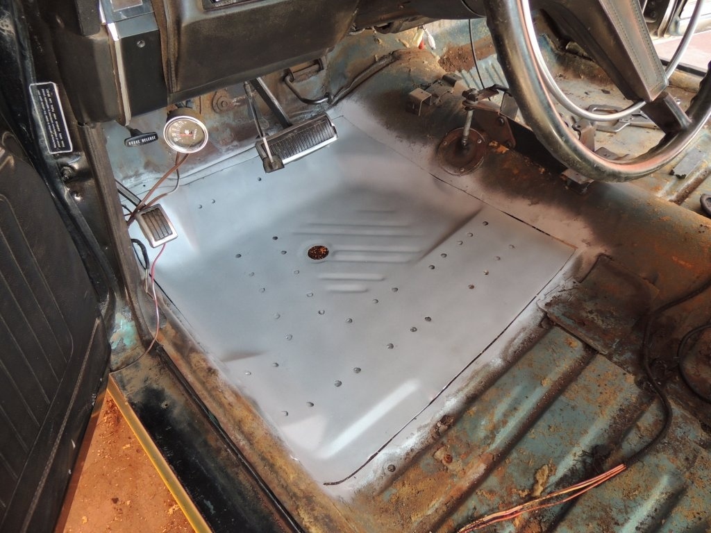

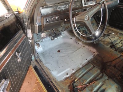

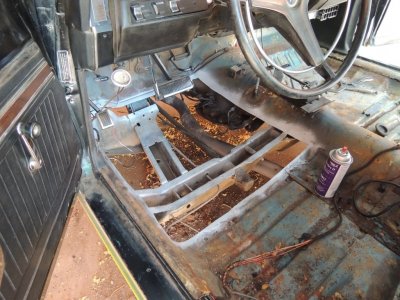

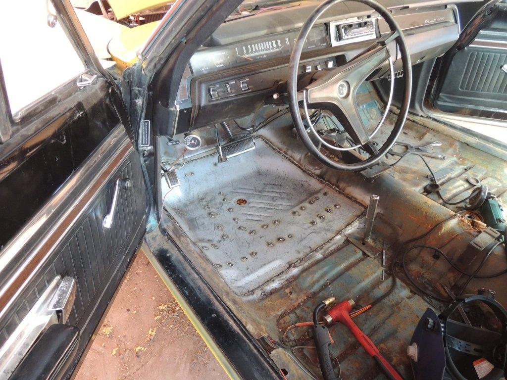

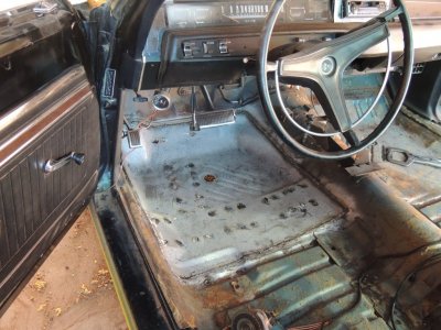

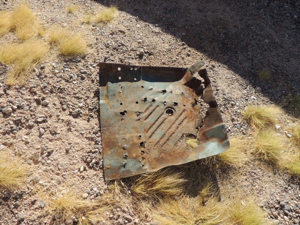

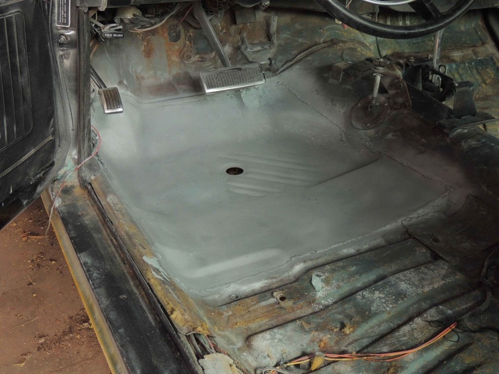

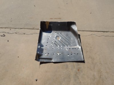

Finally got around to cutting out my floor board (drivers side) and replacing the rust through.

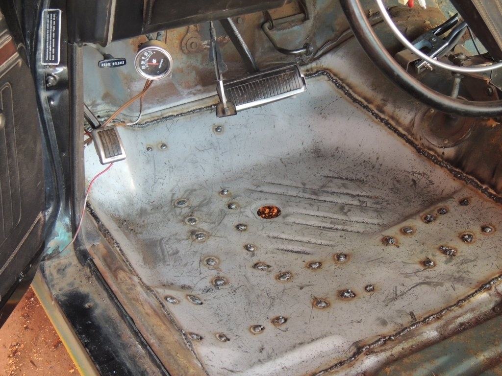

I only had to replace the center section. The rest was in good shape. I see what everyones talking about. It takes a lot of time and patience to spot weld all those holes and the flush seams. No over laid sheet metal here. Butt spliced together and seam welded. I'm planning to bondo the seams. I just ground down the welds tonight.
DSCN3412.JPG DSCN3413.JPG DSCN3415.JPG DSCN3416.JPG DSCN3417.JPG DSCN3418.JPG DSCN3419.JPG
I used a weld etching primer for the bare pan and plan on Por15 for the surface rust in the rear area. I bought the cutting grinder from Eastwood just for doing floorboards and trunk pans. It was great!

Yes, It was fun. Just had rust in that area no other so it wasn't necessary to remove the whole enchilada. I still have the center of the trunk to do yet! I'm trying to save as much original metal as I can the car is not that bad rust wise. I started out using a spot weld drill bit and quickly switched to an air chisel. The bit wore my arm out! Had the undercoating catch fire a few times. Made it easy to fix the transmission linkage though..

I practiced on two pieces of the sheet metal left over after the cuts. Only I used a pre-cut floorboard aftermarket chunk. The spot welding was a bitch as it raised the sheet metal off the beams as you went along it became harder to fill. I smoothed it over with bondo when I was done and this helped cover any small holes there may have been in the spot welds. The primer is a weld capable etching primer so it was easy to weld. But even though running a bead on the mig was easy at #2 setting when you spot you need to bump it up along with the wire speed. If your removing an old one you'll need to drill every spot weld which is hard on the arms. I became teed off and used my arm hammer which got the job done much faster an all but destroyed the salvaged piece. Maybe since it's a donor car just spot cut the welds with a torch? Or a Plasma cutter? In any case have someone near by with a garden hose or fire extinguisher as the undercoating will catch fire!
Here's the end product now some paint and a new hush mat then carpet and it's done!
Next Job: Center Trunk Pan.
