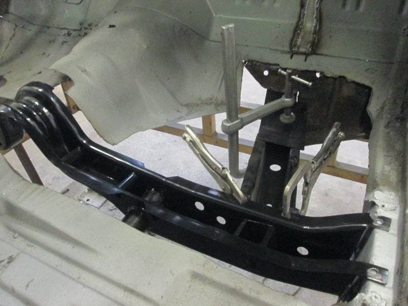

The crossmember tabs are spot welded from the factory...... and the only way to get to them is have the floorpan removed. And yes, you have to remove the wiring cover plates. It seems easy, but it takes time to do it right.
The crossmember cannot be replaced from under the car. The rockers are angled, so the crossmember is "wedged" in place from above.
Always wondered if one side was decent, could just cut and weld near the rocker. Maybe.
