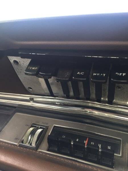

The sliders quit working this morning. I push them and they dont switch from defrost to heat, etc. I take it the switch went bad. Has anyone had this problem and what did you do about it?
The fan is stuck on defrost and I can't turn it off.
Any help is appreciated, thanks.

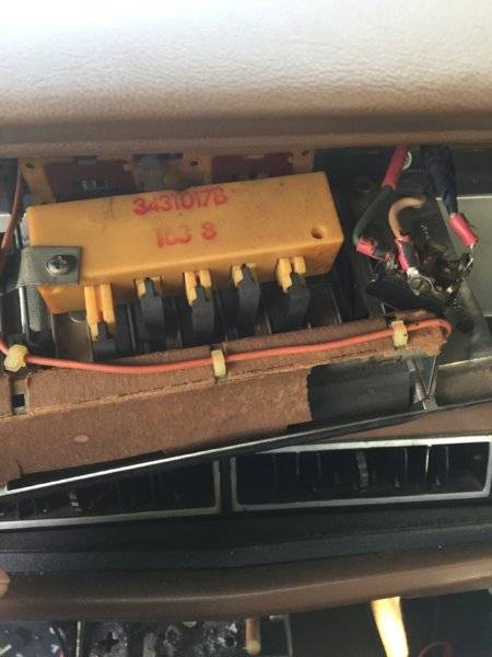

I doubt you would hear much of a hiss from such a small hose. If everything seems to be intact, the vacuum control switch behind the sliders could have failed. They have been known for it. You will have to remove the two screws and drop the controller down to inspect it or replace it if in fact it has failed. I could also be one of the 1/8" hoses or an actuator on the heater box too. Plenty of things to have caused the problem.

I took the screws out but it didn't want to drop down. There's a piece of chrome trim along the dash that looks like it's keeping the control panel from dropping down. I'm gonna go out and work on a little later when it warms up a bit.

Screws out, won't drop. That chrome trim piece that runs the length of the dash is coming out.
So @JimKueneman has on his restoration page how he repaired. Seach for his pages and you will find the rebuild of the fan and vacuum switch.
