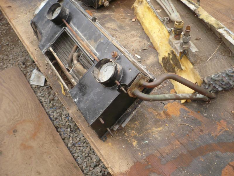

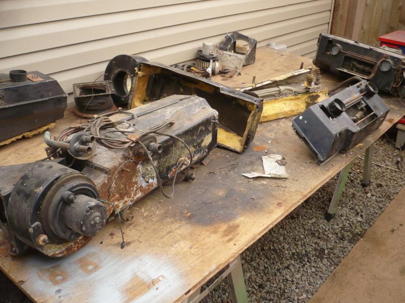

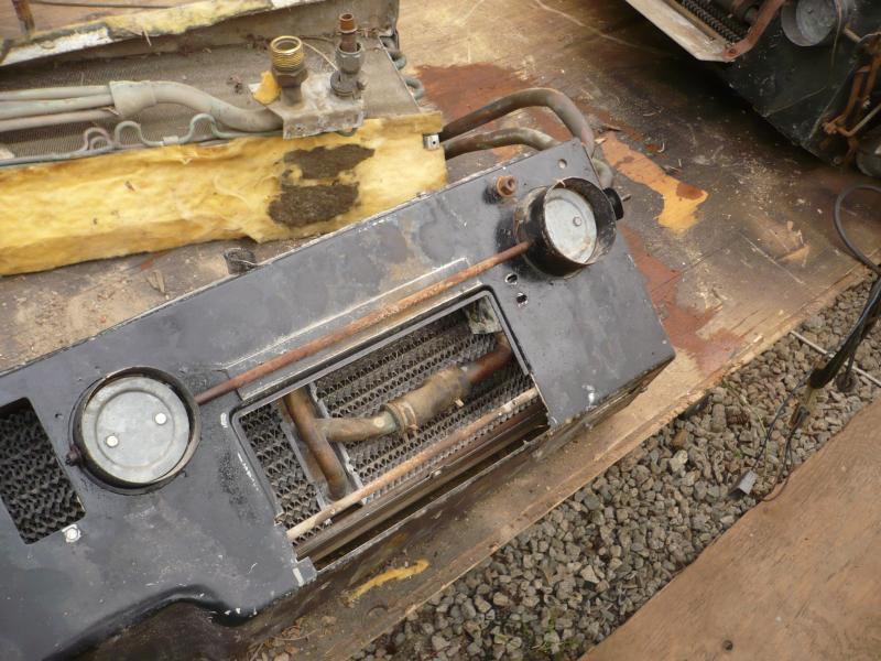

Im starting to restore my AC Unit box. Anyone now how to remove heater core from this part of the housing. Looks to me that maybe they put it in place and then soldered. Not sure.
the outer pipes pull off,they are sealed with orings,spray some penetrating oil & pull & wiggle
Thanks for the help. I did see inside that it looked to be pushed on but thought that it was sealed for good do to being under pressure..
