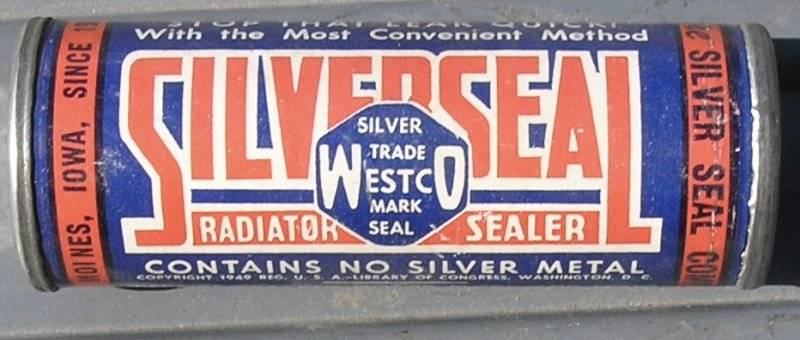

I have heard that putting pepper in the coolant will stop up pin holes. Anyone tried this?
Don’t do it, that’s a temporary fix at best. Cooling system stop leak generally causes more issues than it fixes.

Ginger from your wife's kitchen cabinet will stop the leak. Probably a teaspoon or so. Just get the heater core repaired.

Your system had some gunk like this and when you cleaned it, it started leaking again.
