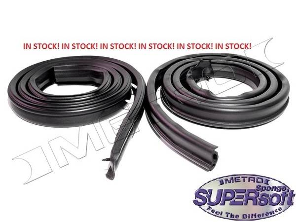

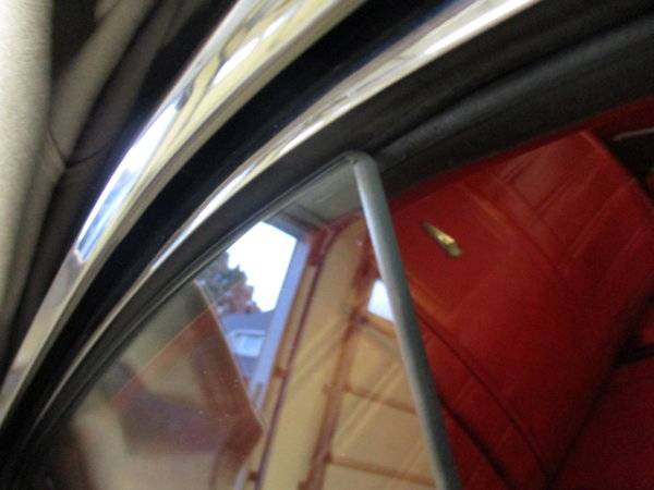

Hello everyone I am new to the forum I am currently working on the roof rail weatherstripping on my 69 Dodge Coronet and I have some questions for any of you who have done this. My replacement seals are Metro and my question is: Does the window go on the outside of the seal or is it supposed to go in the split in the middle. I have attached two pictures one with the quarter window going inside the seal and one with it going outside so you know what I'm talking about. The reason I'm asking is because I can't make the window go into the split in the seal unless I am holding the seal on the outside of the window as it goes up. It seems like you should be able to roll the window up and by itself it would go into the split if that's how it was supposed to work. I looked at my friends 68 charger and the seals are a little different so the window goes up in the slot really easily. Have any of you had this problem? Should I buy a different brand of seals that are shaped more like the originals? Any information you guys have out there would be greatly appreciated thanks.

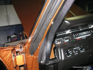

Thank you so much beep beep and themechanic for your responses they are very helpful and I really appreciate it
I too used the Metro seals and just got them as close as possible. Looking at survivors and those that reused old seals the Metro seals are no where close to being shaped like the originals. I must have messed with my quarter windows for days trying to line them up right. Probably the most frustrating part of my build.

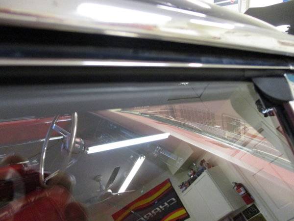

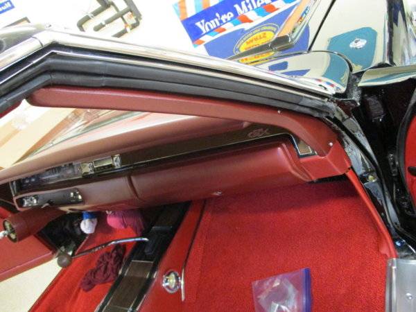

Mine are the ones that Dixie and other vendors carry....The right ones also have "notches" in the rubber to set the seal correctly in the trim that has tabs....
The glass is supposed to meet at the groove and touch the inside lip so it creates a top and inside seal....If you need a close up pic I can take one later...
I used Metro on a 67.
Looks the same as yours.
No way it will work going in the channel.
And the groove is to small anyway.
Maybe the idea is to let it compress the rubber?
I figured the outer rubber was just supposed to compress against the inner rubber.
Seems to be patterned more like a later A body Duster seal that fits the glass the same..

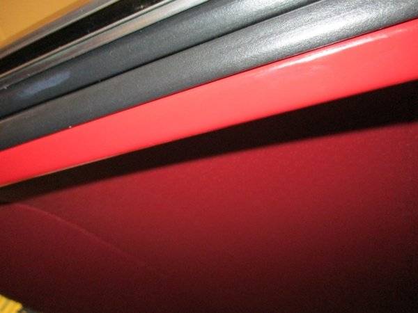

This?
"Soft Seal"?
I'm not seeing an application for 69 Plymouth of that type?
http://www.soffseal.com/store/Main.aspx?html=home
And definitly not one for a 67 Charger.
However mine were "Purple." (Below)
And I think that is what the OP and I are talking about.
Slit. No groove in them.
Not that you can use anyway.
No worries, mine were installed correctly.
Not half azzed.
You saw the thread.
It's a sticky in the 67 Charger if he needs help with the quarters.
But if he finds what ever you used maybe the adjustment won't be necessary.

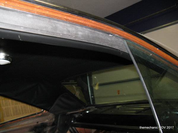

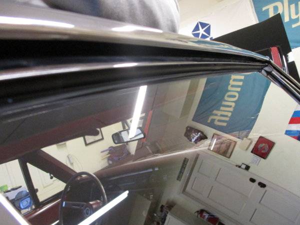

Here is how the glass is supposed to fit in the groove....Clearly shows the glass in the "Groove" not poorly slapped together...It takes a fair amount of adjustments between the glass and the roof rail trim but take your time with it and you can get it to fit correctly...
You are right.
Pictures are a big help.
I see a difference in what we are talking about.
It is not what I would say is "in" a groove or channel.
"Split".
It is sort of resting "on" the split.
Yep. That's the way he needs to make it.
The Metro should be good then.

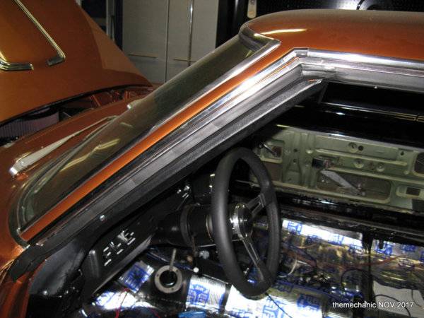

First off, I strongly suggest trying to find good used door and roof rail seals. We have been involved in manufacturing / selling weatherstripping for 28 years now and have seen and heard most of the horror stories. Depending upon the year model and body style makes a huge difference in which brand to purchase. If your doing a 66 to 67 B-Body, the only roof rail seal that will seal remotely is the Steele Rubber piece. For the 68 to 70 B-Bodies, Soft Seal and Metro are the two most widely used pieces. I am hearing all kinds of issues with people using the OER brand of seals. The thing about any seal is that rubber is very inconsistent from production run to run. Even with current technology, cooling time, pressure variations and mix variations will make a difference in durometer readings and thus one set from vendor X works very well and on the next order, your not able to close the doors without slamming them.

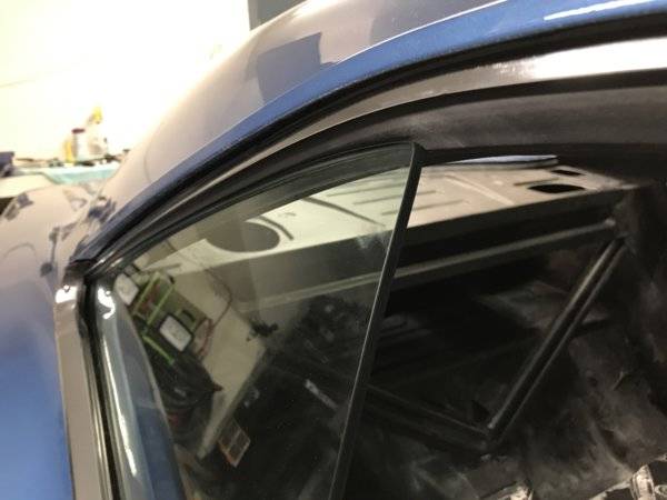

As Justin pointed out in his pictures, make sure that the roof rail is seated properly into the stainless channel. Cocked the least bit and the glass does not fit into the relief. The factory seals have a pronounced rib to aid in installing them. Metro has a tendency to have a bulb size that is slightly oversized holding the glass off. Soft Seal on the other hand is more profile correct, but they have issues maintaining the durometer value which impacts the ability of the glass to seat itself into the relief.
I strongly suggest the service manual to be read and scrutinized when starting to install the glass on any car. There are much more adjustments that most people are not willing to play with to get them to fit right. The best thing I have learned when things are fighting you, take a break from the procedure and come back the next day with an open mind. Take a big swing with the adjustment and see where it takes you and start to dial it in from the two extremes.
