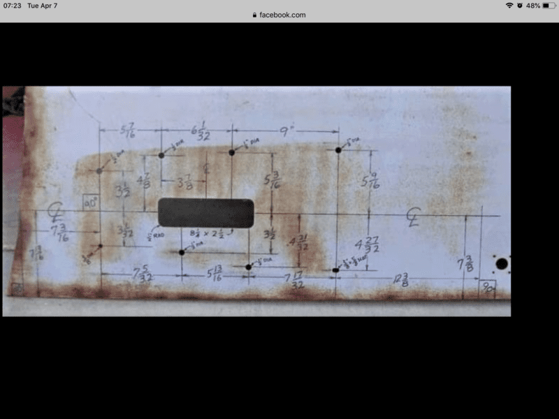

Hi guys,
could someone please post some measurements of the hood scoop position? for the twin hood scoops of 69 bee or Coronet RTs
Thank you!!!

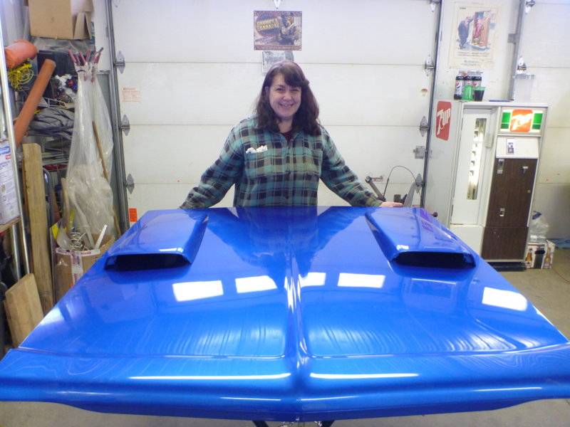

Left one is a tad bigger than the right one... :thumbsup: You'll need to find someone that hasn't mounted their scoops yet to get you a hole template for all the retainer studs.

I see somebody on this site did post a diagram with measurements a while ago, perhaps they will see your post and send it.
I saw that template up for sale too. Think it's on partsmix. It's a few measurements only and with shipping and customs that piece of paper would cost me well over 100$...no.
Search posts on here. There is a perfect diagram here somewhere.
I have searches before but wasn't able to find it.
This gets me closer, thanks! Do you have it in higher resolution?
