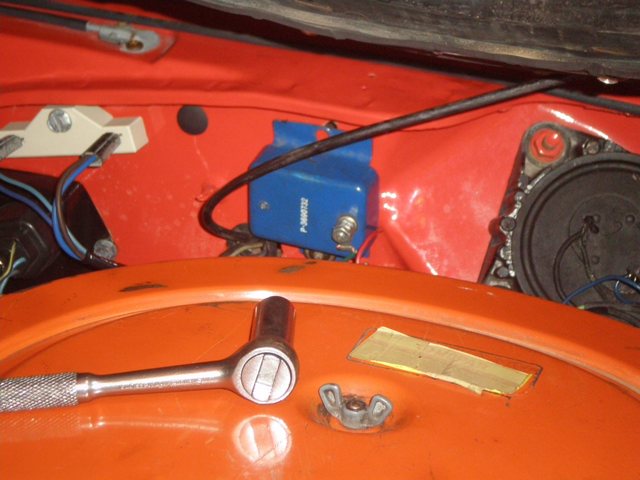

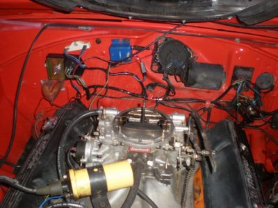

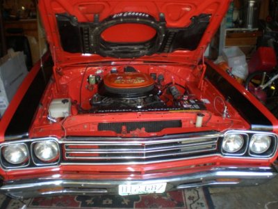

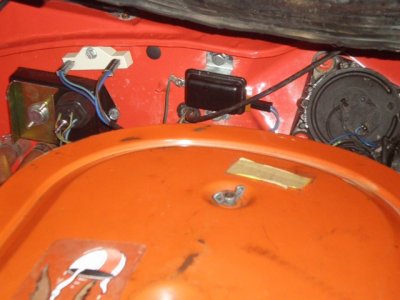

this is the only pictures i could find of my car
its the hole below the blue MP voltage regulator and it has a rubber grommit , also my black solid state regulator I have now changed back to .
that is the correct local for it and it is a smooth nice hole behind that grommit .
I fed my tach wiring out the hole also but I added the tach
