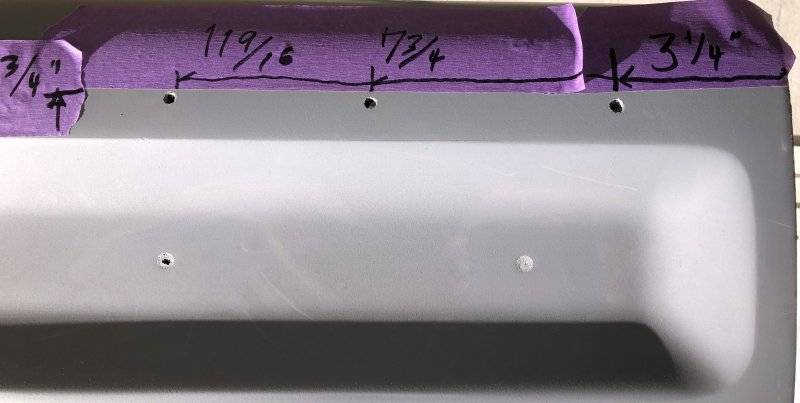

Does anybody have measurements for the placement of holes on the decklid for the “Plymouth” logo on 1969 GTX?

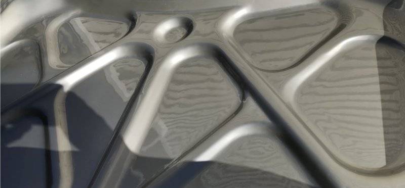

I like your username and because you may never hear back from E-Boog I took a few minutes to make those pics. Centerline of the holes is 3/4” above the character line and the length dimensions are measured from the edge.
Second shot is some A4 I recently shot for my ‘69 GTX. Now I have to make the rest of the car look the same.
Hope this helps.

Excellent! Thank you so much! So many people say “why does your green car have a blue interior”. Lol
