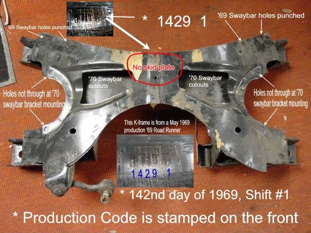

My recollection is an A12 isn't really "early" There were two SPD's both sort of mid year.. The K members should have a typical 68-69 upper but a 70 lower stamping with provision for the sway bar to pass through the K member.. There's more to it than that but thats the big flag for a correct vs incorrect K on an A12
Here is a post on another site about the A12 K-members. grabbed this picture from that site below.
https://board.moparts.org/ubbthread...id-1969-a12-cars-have-a-special-k-member.html
