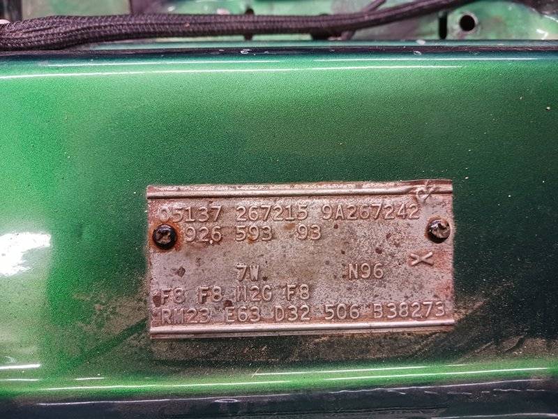

I am hopefull someone can decode this tag. I have figured out its a 383 four barrel and air grabber, and F8 paint.
Any assistance would be appreciated
Lynch road tags don’t tell you too much. The whole top row is production information for gate number, sequence number and vin number.
926 593 93 are for info regarding radiator size, differential gears and or sure grip and I think 63 is trans info.
w2g f8 and 7w are interior colour and style codes.
f8 f8 exterior paint codes
e63 motor, d32 trans, 506 production date, bnumber I think is order info
Is it possible to determine if it originally was bench or bucket seats?
7W is white pin stripe, N96 is fresh air hood. D32 is auto trans. H2G is your interior code, I don't have my book in front of me at the moment, but that will tell you bench or bucket.
926= Engine assembly = 383-4bbl For a B body with automatic transmission. Rated at 335 horse and painted orange.
593 = rear axle assembly = B body with 8.75 axle; 3.23 gears. No Sure grip. 11" drum brakes.
93 = last two digits of the part number for the applicable automatic transmission = 28920093. Some LR tags show the full 093 coding. Some show only the 93.
A green one. I think a hardtop automatically got the upgrade bench style. A sedan could have either the taxicab bench or the upgrade. So, column shift for the 727.
A 69 lynch road tag would show a "26" if it needs the big radiator. No 26, it gets a 22" core and core support.
If that's W2G, it's a white & green interior, which could be the Decor bench or buckets.
If it's H2G, that's all green, and the Decor bench.
But for '69s, the UDF with white door cards, armrests & seats would be white; '68s would be green UDF.
That 3rd F8 indicates UDF, IIRC.
Bucket cars of course had 4 more holes in the floor for the inner seat tracks, but a lot can happen in 50+ years.

Pretty sure that is H2G. If you compare to the W in the W7 just above it, definitely two different shapes. Green deluxe bench, cause it's a hardtop.
I have never heard of a W trim grade in 1969. In any case it is the number in the middle that determines the seat type.
Yeah, I've never seen an interior trim code starting with a W; was keying off possible colors and fell down the rabbit hole, haha.
I'd also bet on H2G, as I think I suggested.
