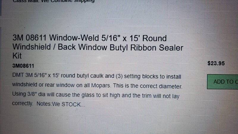

3M makes a Butyl tape kit that was used on the back windows and with the kit comes two rubber blocks.
You can use either the 3/8" or 5/16" kit. Be careful with the clip placement! No gasket was ever used.

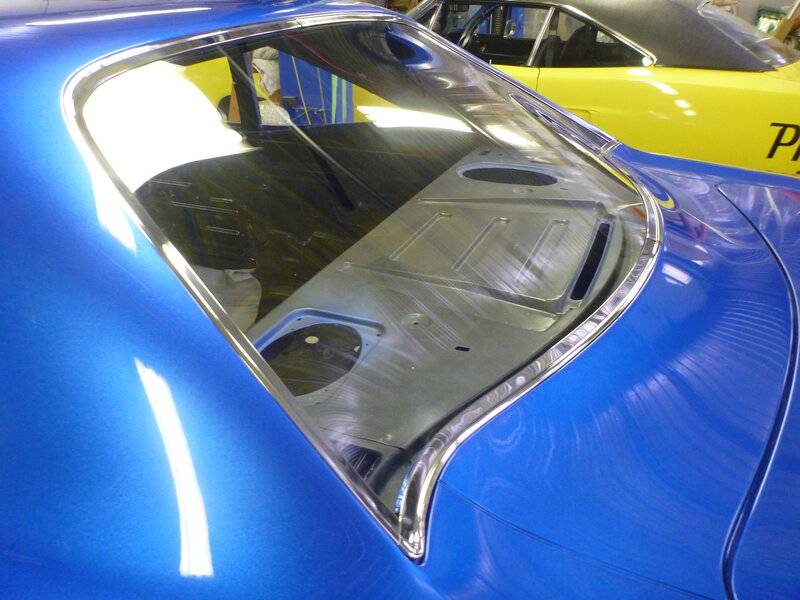

I don't see 1/16" making a big difference. I used a heat gun to warm the interior package tray area and pushed the glass down to get a nice seal. The trim had better look nice, as my paint guy sent it all out to the most expensive chrome and trim polish guy in Canada... before he'd told me he did so!

I've heard 1/16th does make a diff, but with the 3/8", you have the extra material for sealing. Those back glasses
