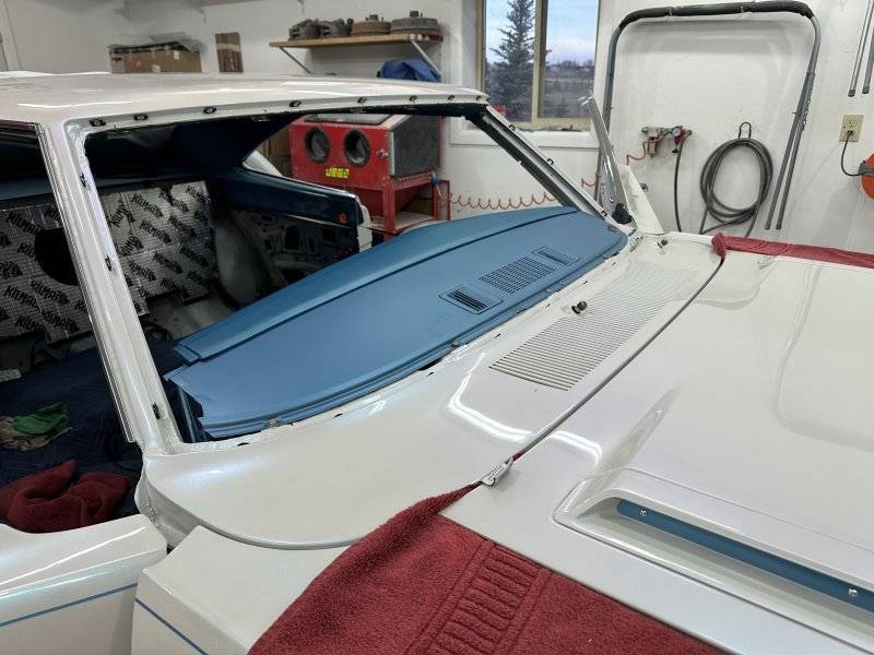

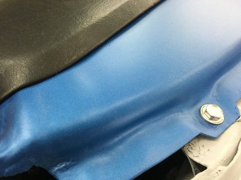

I have always re-done the dashes with a base color of your choice (base color from a 2 part gun shot system, no rattle can) then rattle can SEM matte clear dusted high and dry. 3-4 coats until the sheen of your liking is achieved. Turns out perfect every time.
68 Runner, U1 Blue.
72 Duster, B5 Blue.
