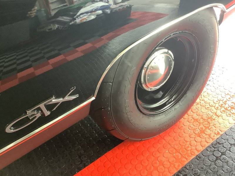

295/65R15 on 15x10, the only change is the addition of Super Stock springs. They are tight though, before you purchase wheels and tires measure BOTH sides carefully. Clearances can vary a lot from side to side and car to car…
275/60-15 will easily fit any ‘69 B body
Exactly the car I think of when someone asks about 15x10s on a B-body :thumbsup:
If you run a straightedge along the outside bulge of the tire, how much space do you have to the quarter lip with that setup?
The closest gap between the inside of the wheel well lip is 5/8” on the drivers side and 3/4” on the other. The closest point of potential contact is the leaf spring at the back of the tire, slightly less than 1/2 inch.
