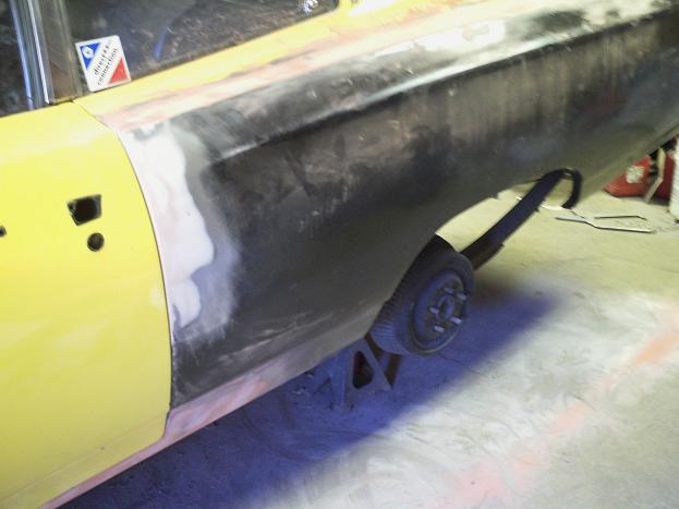

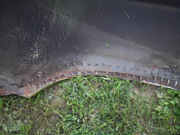

What is that pop rivets with tails?
very "creative " bodywork. the 1/4s were heavily patched, and the "bodyman" aparently never heard of torches or welders, but was born with a rivet gun in his hand. thankfully the rest of the car is very clean.
Looks like body filler that ran threw the holes. I wish people that were unwilling to do things right would just leave things alone. Great car looks great

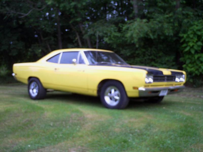

I owned a '69, Y2, 383, 4 sp, bench seat, post RR from '76 to '87. I live in the SF bay area. I wonder if I am a previous owner of your car.
Some unique things about my car that you can check for:
I painted the tail lights black like GTX tail lights.
I installed street hemi leaf springs with lowering blocks and a street hemi dual point distributor.
I installed a pistol grip.
There were a couple of small "puncture wounds" in the lower dash below the ash tray.
I painted the engine bay flat black.
The license plate was 681 PGF.
Is this the same car?

I had to look at it for a few minutes but I know exactly what that is.

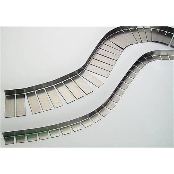

They took "repair strip" and pop riveted each tab to the outside of the quarter panel with the repair strip lip mating up to the outer wheel house lip, then they just slathered mud on from the outside and that's the squish through we see on this side.

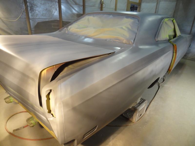

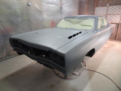

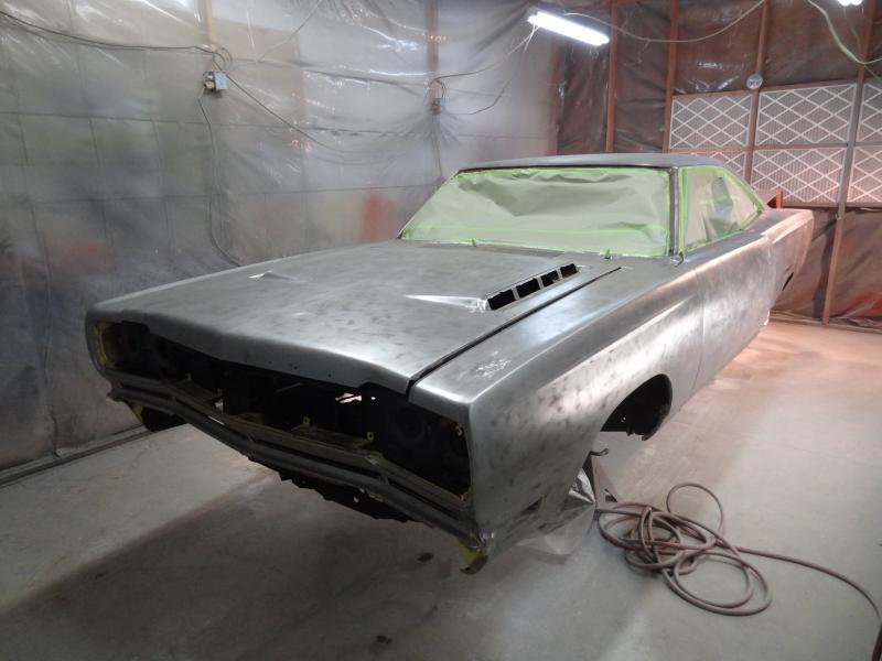

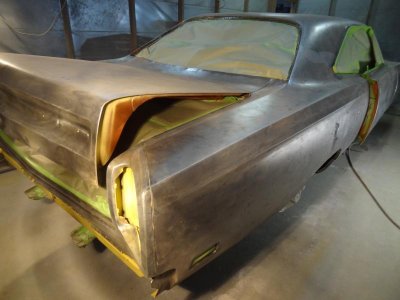

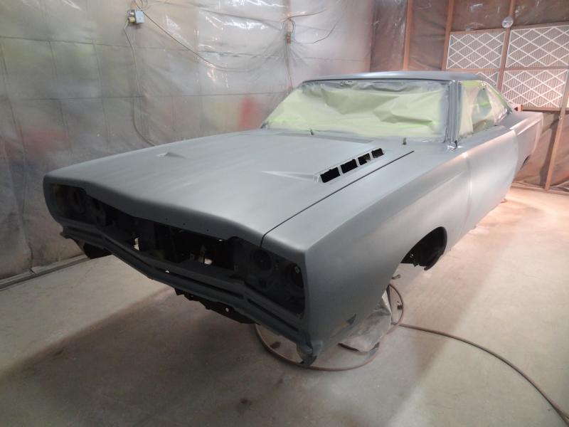

Looks like your car is getting done right, wow amazing work on the quarter skins, I can't see the weld seam in the pre-prime pics.
