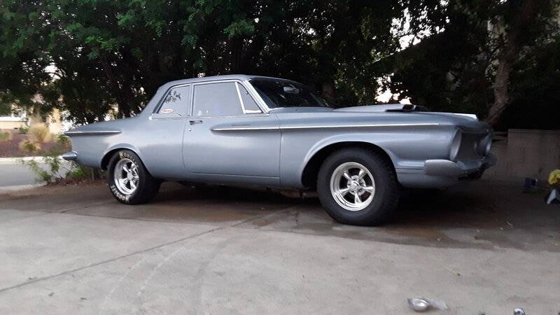

I just measured from the center of the hub to the front edge of the wheelwell opening on my 69 runner, and my 62 savoy. Both came out a hair over 15" . So, theoretically, it could work. It would depend a LOT, on the width of tire, and most of all, the offset of the wheel you want to use. With most of the tire to the inside, i.e. a large backispace number, I think it will work. Any b.s. less than about 4.25, I would say no way.
The pic is of my Savoy with a 235/75x15 on a 7" rim, 4" b.s. 29 inches tall.
