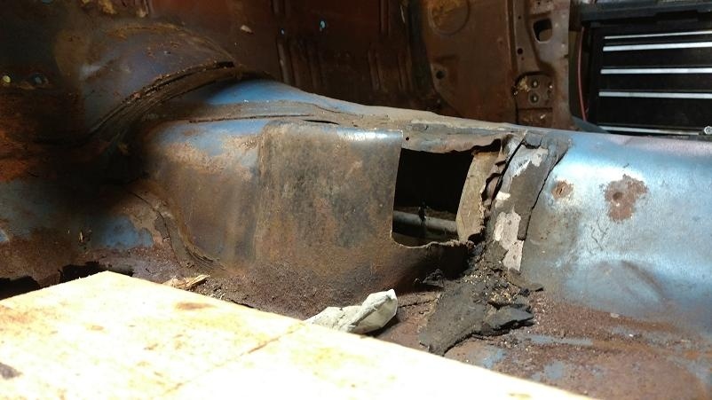

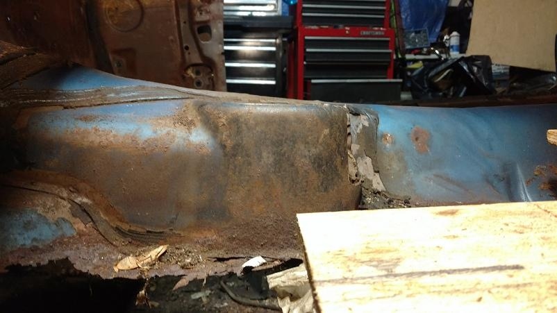

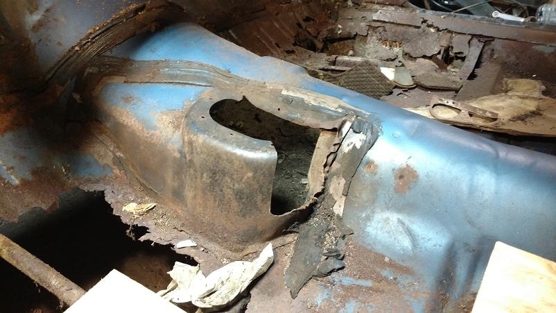

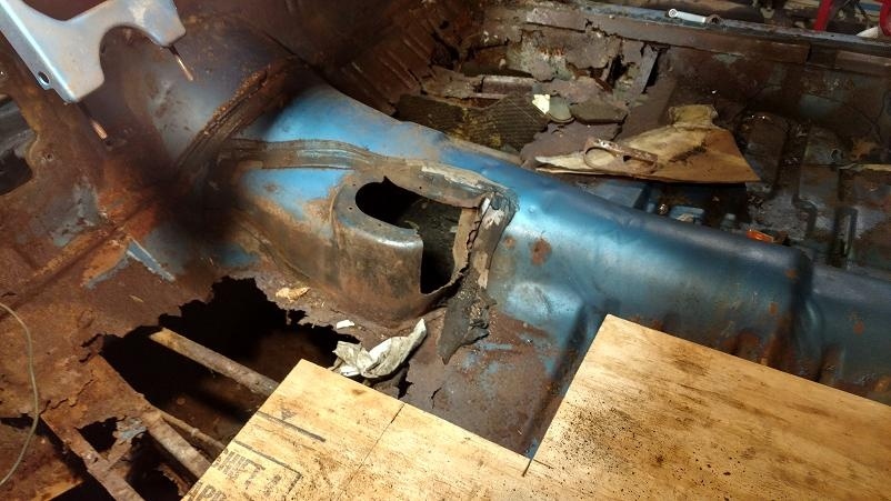

I am currently parting out a 68 4 speed car. The back of the tunnel was cut to accommodate an old Hurst Ramrod shifter but most of it is there. Hope this helps.
Perfect. Thanks guys. This should solve the mystery. Thanks again.
