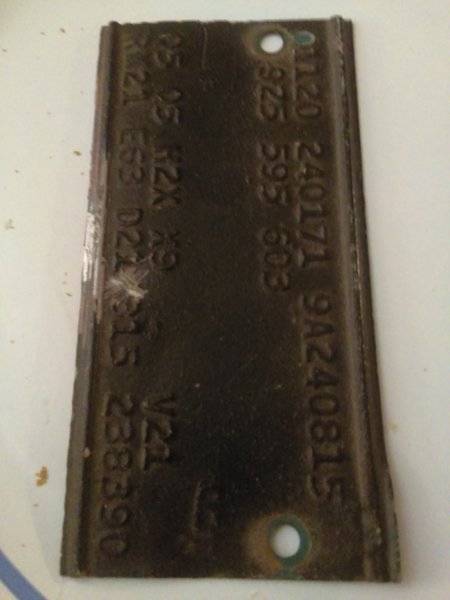

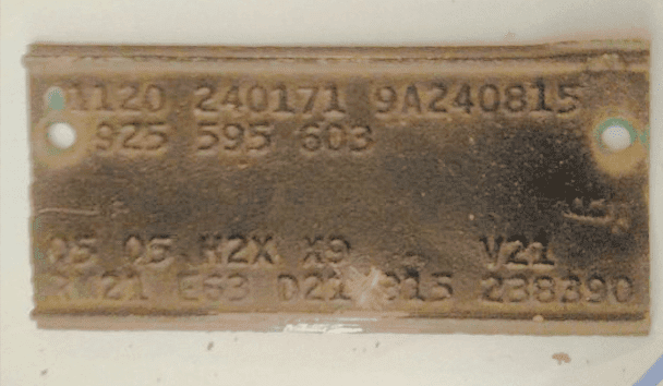

Here's the tag, any help would be nice. Thanks in advance for taking your time to help me.
Some information here.. on the upper left hand side of fender tag screw hole, there is a five digit number. Cannot see it very well in the photo, but there is a (0) in front of the 1120. Number reads
01120. Just a FYI. Thanks, Dodge33

Thank you for sharing your tag. There are several of us in the hobby that track the data they provide. Lynch Road is unique in many ways. While the SPD is shown on the tag, the actual build date may not be close to this date.
With this said, you car was built very close if not on March 15, 1969 examining the data currently available. It would be a day earlier if not the 15th. The more data we have the more dialed in we can get with the actual build dates versus scheduled build dates.
As I am typing this I see 69Coronetrt has chimed in. Yes, I concur!
