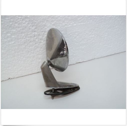

Hello all, my 69 roadrunner had a driver side mirror that was not a remote type mirror. The guy that was doing my bodywork has lost my original mirror so i am now looking to replace it. The problem is all of the mirrors i see used or re pop have remote cables. My door has no hole for the remote either. Does anyone offer a non remote driver side Roadrunner mirror? I seem to remember mine looked just the same as the remote versions but its been a year since I've last saw it. Any help would be great, thanks!
I seem to remember it looked like this:
They are the same minus the cables and knob. You'd be better off buying a repop and cutting the cabling off.
Wasn't the Pentastar mirror the option for manual mirror's?
Could be way off here...just asking.
I think Prop is right. My '68 came with a manual mirror and it is the same as the one pictured in Prop's post. The '69's should be the same. The backside of the remote mirror is different from the manual mirror so you may not want to buy the remote version and remove the cables. You can buy reproductions of the manual mirror but they're often listed as being for the passenger side. My understanding is you can use them on either side, however. Here's a link to one from MegaParts:
