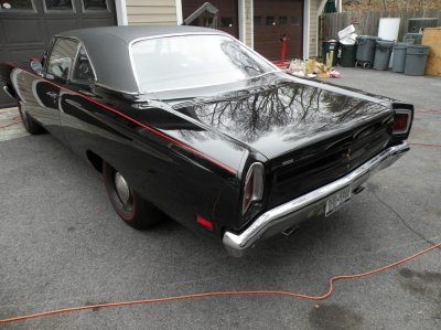

Mine come on...
yes always. they should be on with the parking and headlights on.
