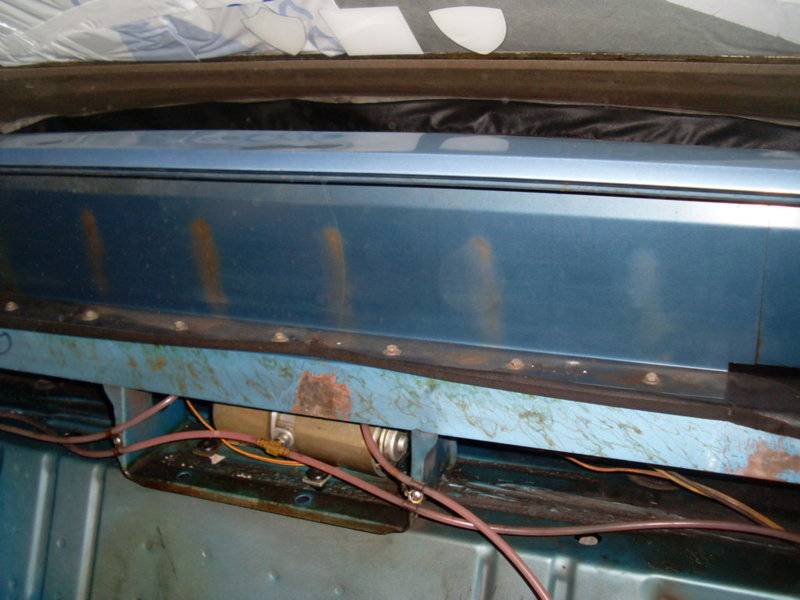

Hi guys, I did not take it apart but i am putting it back together. There is a panel between the rear seat and the rag top, there are about 10 screws to hold it to the body. But it is flimsy, i think there should be more than that panel, braces or supports ??? Any help would greatly appreciated.
This panel?

Mine is at the shop...from memory you have the screws shown and there are either 1 or 2 sheetmetal screws that tie the outside edges in. There should be a 90 degree bent edge on the outside.
It screws to the inner rear side panels with the same screws that hold the washer bottle in.Three on each side. It also locks into the upper seat back and then with the top boot. Very secure.

Ok that is great guy,s i knew i could count on the B Body Boys. So i am not missing any parts. Thanks again. I will post some pics later. John
