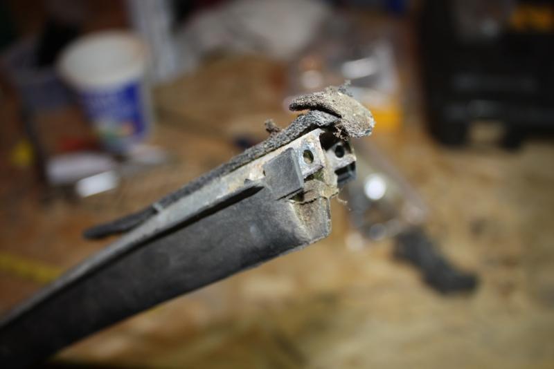

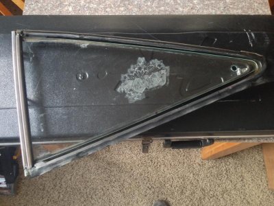

I need some help with restoring my pop out vent windows on my 69 rosdrunner sedan. Does anyone know how the glass comes out of the frame? I can't seem to get them out and I don't see any access points or bolts holding it in. I was gonna replace the seals but I can't seem to figure it out. Thanks!
I am at the same point.

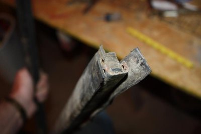

It looks like there is 1 rivet in each of the 2 corners where the glass is mounted. I think I see a plastic rivet/block on each end of the glass mounting the glass to the back of frame.
I am thinking those rivets need removed so the frame will come apart and the plastic rivets/blocks will allow the glass to slide out of a channel.
I don't know if my explanation was clear enough. Sure would like someone that knows to chime in and shed some light...
The rivets need to be removed. The glass will then slide right out of the channel. The glass anchor is the same as slide on the front of the front windows. You will want to look at this and replace if necessary. The rivets are unique, but available. The tool to install them is the expensive part.
