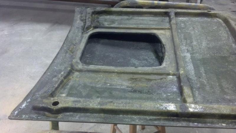

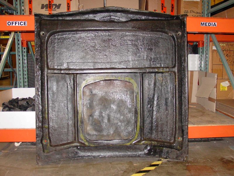

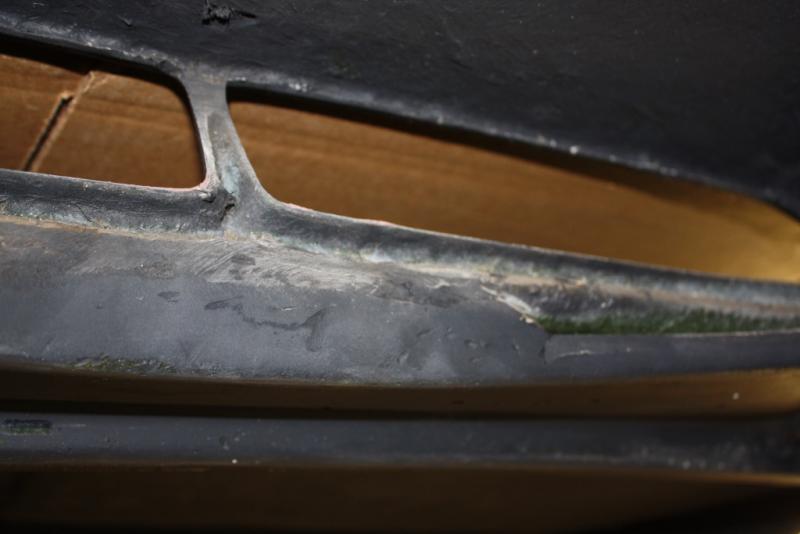

Reproduction hoods are pretty easy to identify. The underside of a reproduction is quite smooth compared to an original. There are specific details by the nose piece of an original on the underside as well. The original hoods will also show the original hue of green fiberglass in the wear areas.
The original and repop in the pictures are a RR and SB, but you will see the difference in finish.
Hope this helps you identify what you have.

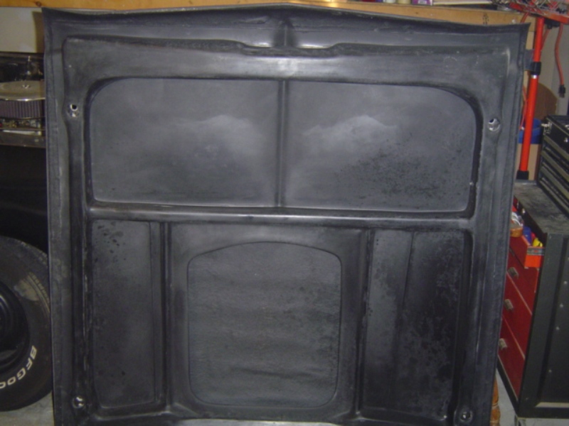

The two hoods I previously posted are from a Roadrunner and a Super Bee respectively. The first one is a Roadrunner which does not have the center ridge like the Super Bee. The Road Runner hood is the original. The texture and green hue are the two items to look for. It will never have the center ridge, original or reproduction.
The second picture is a reproduction Super Bee hood. The finish is very smooth as I believe these are injection molded versus form made like the originals. The original hoods have the center ridge as well.
A picture of my original Super Bee hood during repair/restoration. Note the texture compared to the one above.

Mine appears to be a re pop. Smooth finish on underside, and no green hue. Oh well it still looks great!
