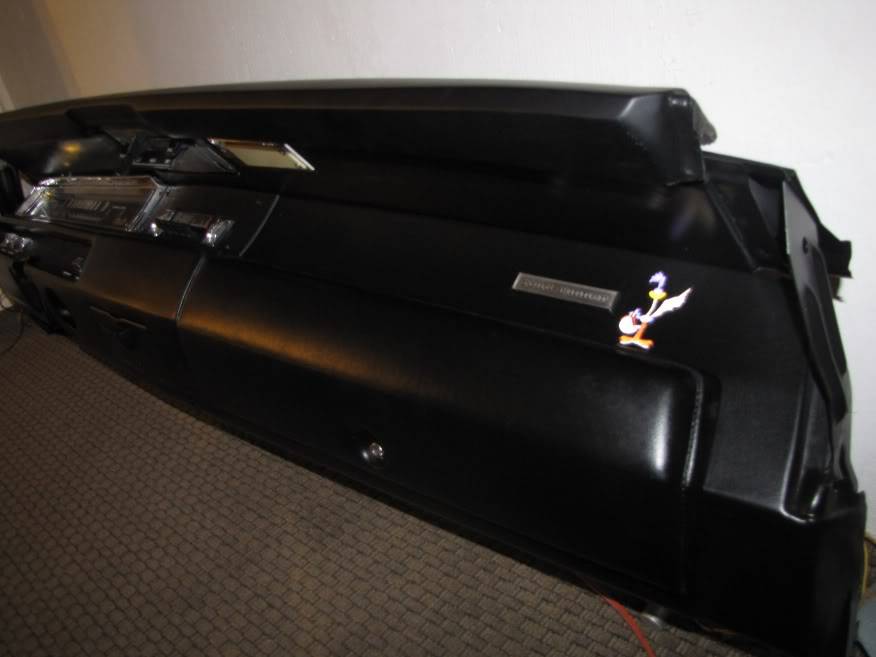

Hey guys, my newly acquired 69 RR dash looks like it is missing a bunch of parts. I'm trying to decide if I should restore or just make some custom dash panels.
Does anyone have an exploded view of the dash so that I can what I'm missing and how far I would have to go to restore it?

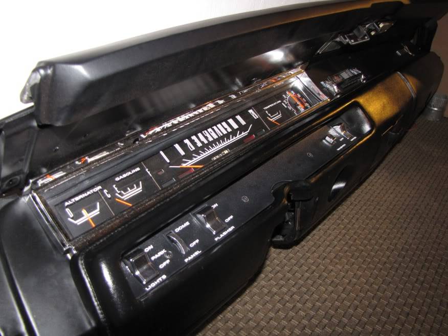

If you post some pics of what you got I could tell you what you're missing
Does this help?
Thanks Prop, that helps....any chance you have one from the other angle (passenger side)?
Separate. They repop it.
Matt's correct. One thing I should point out is that the top lip of the bezel was painted a semi-gloss black from the factory. I paid $50 bucks and sent mine to Vacuum Orna-metal in Michigan for it to be replated. Turned out great and I decided to leave it chrome
What is the proper name for the black trim plate that the RR logo is mounted to? (it is completely missing on mine).
There is no trim plate. It's not like a satellite/GTX that has trim all along the front. It's just the metal core of the dash. The only type trim on the dash is the radio faceplate and the chrome plastic cluster bezel.
