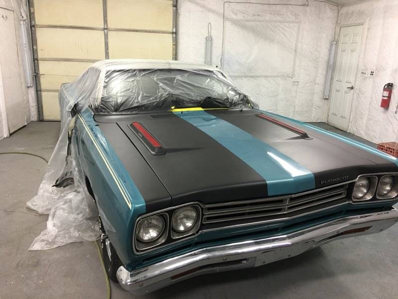

My car is finally painted and I am in the process of having the body shop install the hood stripes. My car is a factory vinyl roof with the performance hood stripes and no air grabber.
Can someone please let me know the correct measurements for the stripes. I have found two on the internet but not sure which is correct.
What is everyone using for paint? The car is painted F8 with Green vinyl. The body shop recommended HOT ROD satin black. We probably won't clear the satin black but I am not sure how well this would hold up? I think if we clear them it wouldn't look correct. If anyone has pics that would be great.

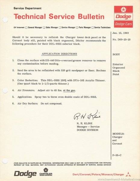

Originally it was Organisol..........
And it had a high texture to it. It wasn’t just “flat black” as far as I know. When I painted my hood with organisol, it came out of the gun like cotton candy. A call to the manufacturer and they said this happened frequently and they didn’t have a recommended fix. I thought, well, if I am stripping it for a respray, I might just try to fix what I got. So I used a Scotch pad and smoothed out the cotton candy so it was closer to just textured. But the color was medium gray - not black. Then rubbed it down with reducer on a cloth pad and the black color came back without changing the texture. It was beautiful. Many older Mopar owners have commented that my hood stripes are the closest to original that they have seen.
Thanks guys for the info. Who sells the organisol and is it hard to spray?
It is a lacquer........The trick is the proper pressure, volume and distance from the metal to achieve the correct look.....As long as your painter is familiar with lacquer and the prep involved....He will have to do spray tests to get the right look.....
Performance car graphic, Frank Badalson and Instrument Specialties sell it....
There was a video I saw a year ago showing how to accomplish it correctly...I just can't seem to find that....

Yeah...depends on where you bought your organisol......I only purchased mine from Frank Badalson, DP and IS....That is why I had no issues relating to the original texture look....In addition I knew how to paint it properly.....
The factory original had "suede" in it and that is no longer added they add a metallic into the paint.....So you have to approach it as such when applying it...

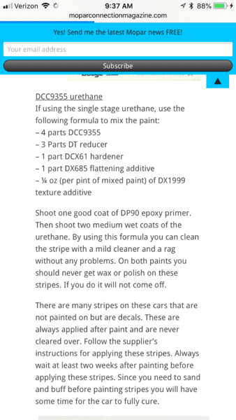

The formula I used. To clean the textured paint I use wizards matte paint detailer. If you wanna go Chevy style, paint it hot rod black, haha

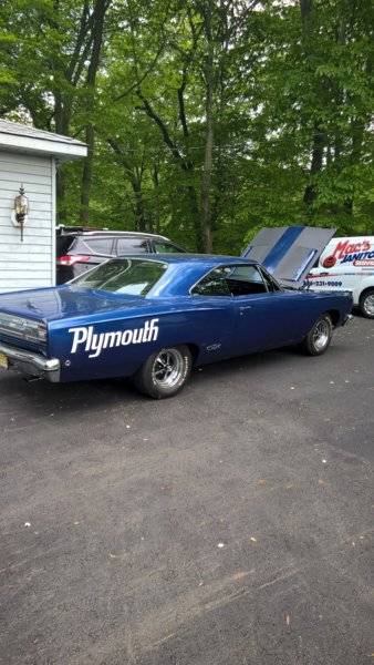

Thanks guys for all the help. Scatpack & 68gtxman those stripes look great.
