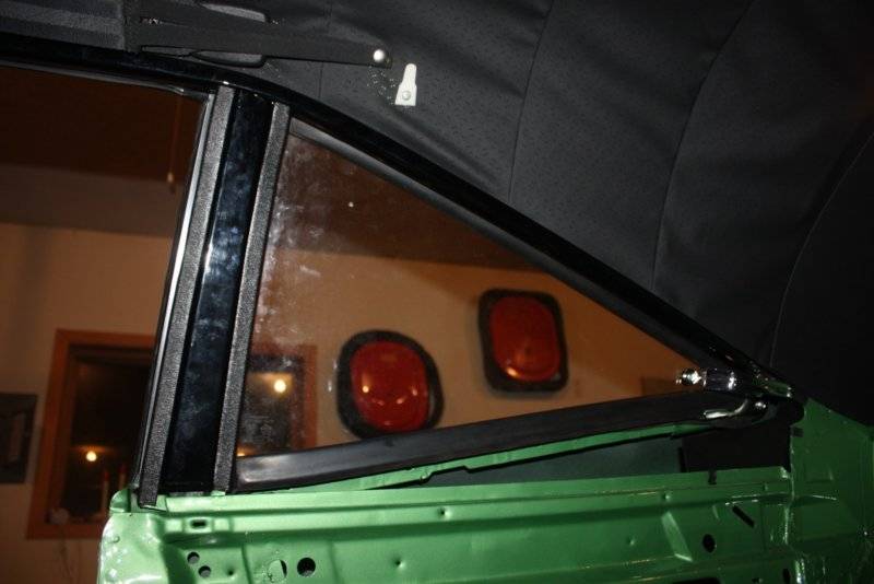

There are no covers. The post is painted the same color as the rest of the interior. The edges are protected with rubber "windlace" mouldings.
The post will be the same color as the upper door frame. The wind lace will also color matched to the UDF color. This is a picture of a Super Bee, but the Road Runner will be the same.

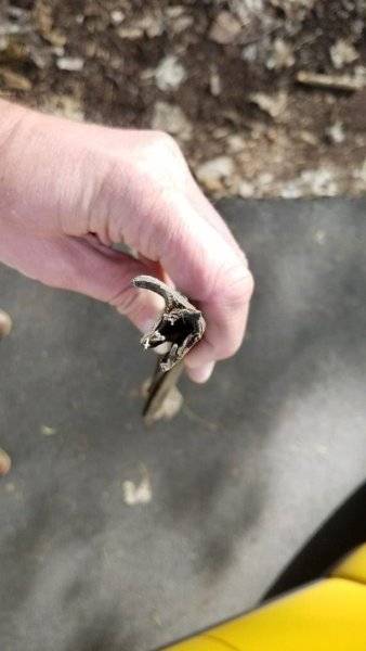

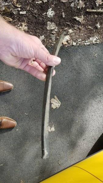

I will see if I can get a picture of the wind lace edging. It is different than what is down by the door panel.

I've yet to find anyone who reproduces that particular windlace BUT if you find some decent pieces they take SEM real well !!
I know of no one that makes this trim. I look for them at every swap and see very few through the season. I do have a few extra if you are in need.
