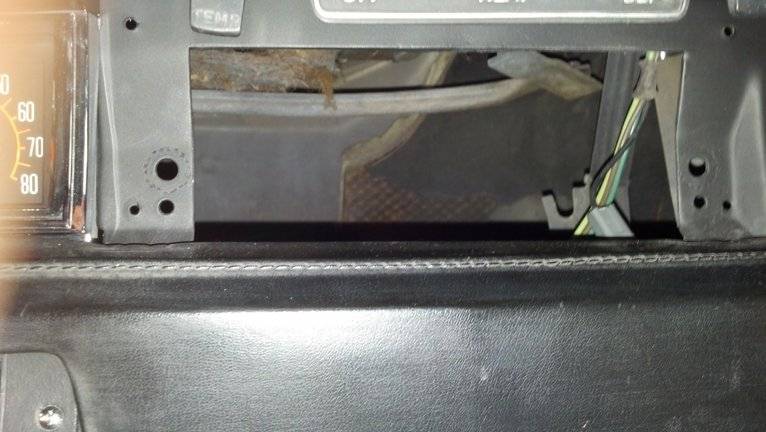

Did all the RR radios have to two roller selectors as shown in the pics above? My dash has two holes (like the mid 70's radios for the volume and tuners knobs) Just wondering maybe someone modified the dash....any pics of just the dash itself?

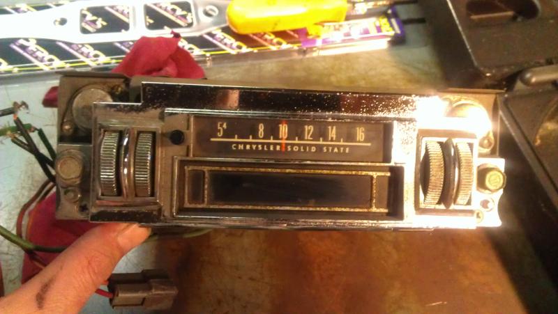

Is this one? could be for sale if needed..

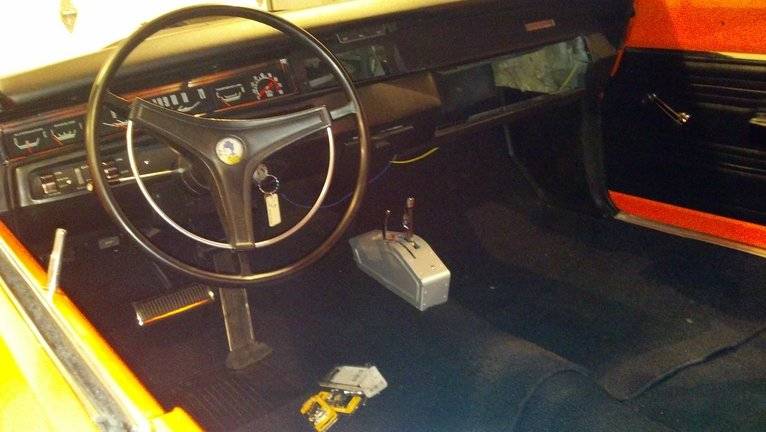

Looks like I need to take a Pic of my dash to show you what I'm talking about....give me an hour or so...
O.K.....here is a pic of my dash....Has it been modified????
I also threw in a couple more pics of the car ;) It's almost done!!!!!!!!!!!!!!!!!!!!!!!!!!!!!!!!!!!!!!!
Nice looking car ! Great job. I believe that those holes in the panel are for the mounting bolts. An easy way would be to measure the distance of the center of the holes. I can measure the mounts on my radio and that should give you an answer. Just a thought............
Nope....Not modified. The two larger holes (where there is a serrated circle/imprint around the holes), is where the radio mounts in the front. Look at the Radio above your post, the two bolts just to the outside of the thumbwheels are the bolts that secure through those holes. Might want to use a rounded cap head bolt with a star washer so the head of the bolt isn't backed up against and pushing out on the plastic radio faceplate. The other holes in your dash are for the centering pins (2) and 4 more for the faceplate screws. Also, that U shaped slot inside the dash on the bottom right side of the opening is for the rear radio mount.
Good luck, cars looking great!
